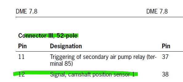

997_986 07-16-2026 01:08 AM
P0343
CPS on bank 1, bank 1 is on the right side of the car. You need to measure on PIN C/12 which is on the third plug from top of the DME, see manual. If you look closely on the pugs they are numbered.http://986forum.com/forums/uploads02/c121784192863.jpg
exiledrebel 07-16-2026 06:26 PM
Thanks for your reply. My car is a 2001 US-spec version with the DME 7.2. The pins for the CPS are different from a 7.8.
997_986 07-16-2026 10:41 PM
OK, probably Tiptronic?
But in any case you can follow this procedere to analyze it if you know your pins.
exiledrebel 07-17-2026 09:20 AM
Thanks for that link. That's very helpful and more detailed than what I found in the Bentley manual. My car is a 6-speed manual.
