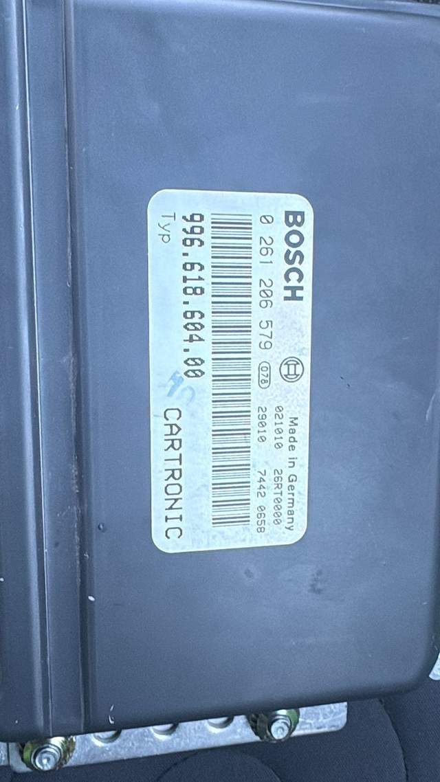

Please understand that my knowledge on the electronics side is limited. From what my friends who have been helping me have explained to me, The key is being read and the immobiliser recognises it, it seems to be more the communication between the m534 and the ecu.
The DME is a 7.8 if I remember

http://986forum.com/forums/uploads02/ECU1764150739.jpg
