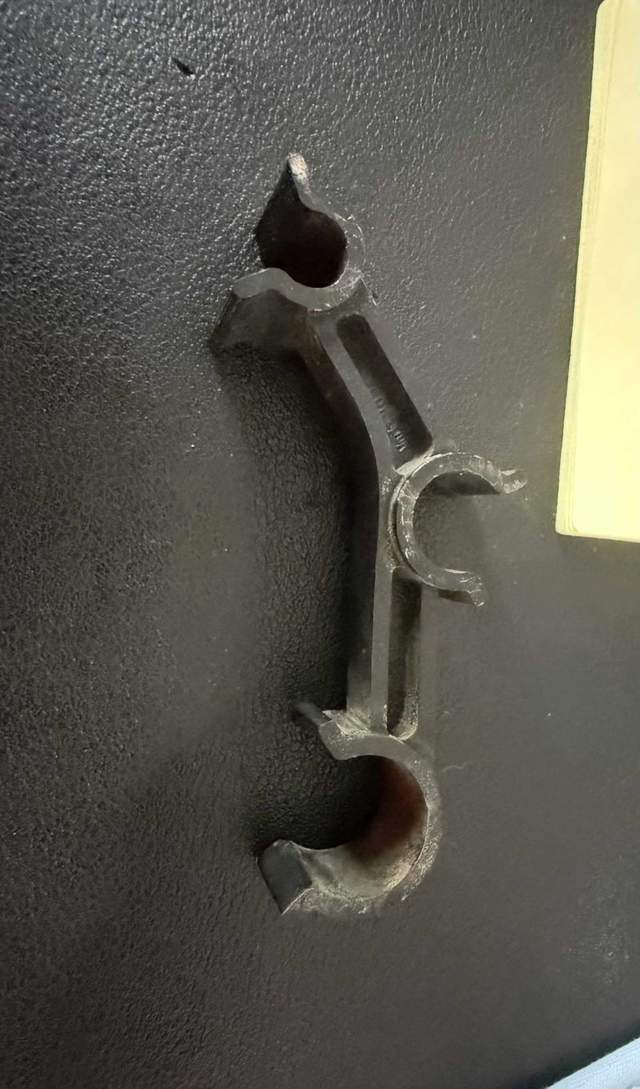

Separately, not looking to create a separate thread for each dumb question I have - anyone have a guide on where this line fitting goes? 986 347 777 00 - support for pressure line (Power steering). http://986forum.com/forums/uploads02...1750087216.jpg
