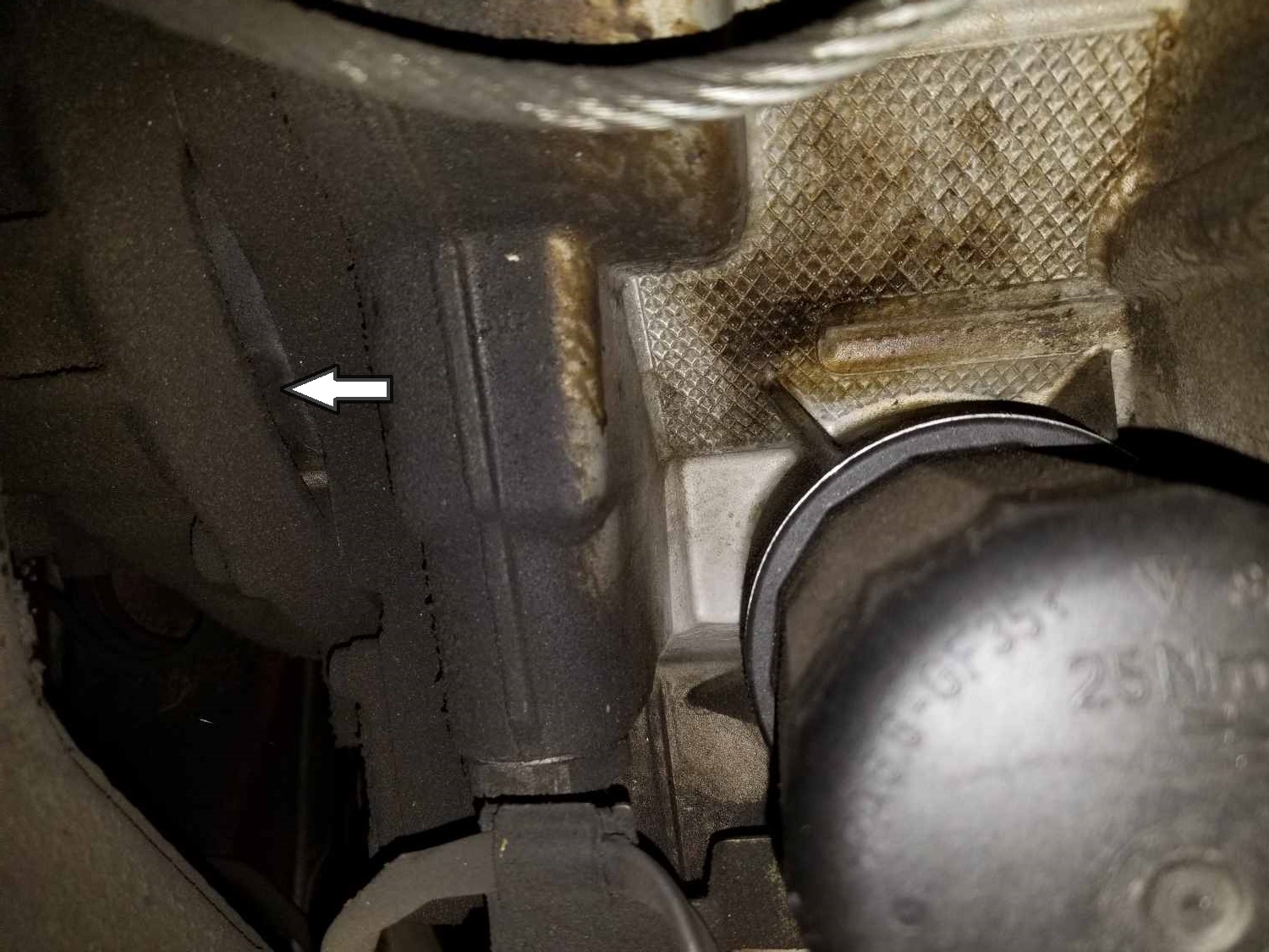

I went under to take more photos. Look at all the black soot :(. I dont think this is all as a result of the spark plug tube leaks. I stuck a finger in the opening of where the white arrow is pointing. It was dry. The white arrow also points towards the rear of the car, for reference.

78F350 08-17-2023 10:34 AM
That oil at the rear of the engine could be from the rear main seal, the IMS bearing seal, or just residual oil from the spark plug tubes..
If you are planning to work on it yourself, do the spark plugs/tubes and clean the areas where there's oil. Drive it after it has been cleaned and see how it looks. If it is still leaking somewhere it will be easier to identify.
If you take it to a shop and say, "Fix the oil leak." expect them to say that it needs a new RMS (and IMS while they are in there). ...Clutch, flywheel, mounts coolant tank and AOS. A dealership or respectable Porsche shop could give you a bill of $8,000 to $10,000 once they get finished.
Does it need all that done? Probably not, but it's all maintenance that can easily be added on to an old 986 once you get deep into it.
Again, I'd recommend doing the spark plugs and tubes yourself and the driving it for a while to see if it's acceptable.

DShen 08-19-2023 01:07 AM
Okay so I started the car for about 2 mins to warm up the oil. Got under and saw the leak in the photo attached. I then changed the spark plug tubes (they were definitely also leaking) and plugs, and did an oil change. Very very tiny bits of metal on the magnetic drain plug. I checked the oil filter and it was super clean, just oil. So that rules out IMS leak?
My guess is RMS leak. As stated the last time the rms/ims/clutch was changed was 40k miles/9 years ago.
I'll inspect the engine from the top to see if there are leaks from up there. What do you guys think? RMS for sure?
