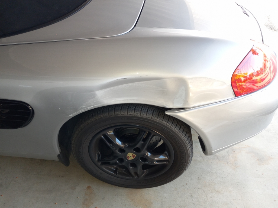

Starter986 05-03-2022 09:53 AM
Attachment 23323
I've read a variety of posts/threads about the repair/replacement options. Replacement i$ out of the que$tion. I'm waiting to hear back from the PDR guy.

Smallblock454 05-03-2022 10:12 AM
Unfortunately this damage can not be fixed by PDR repair. The problem are the hard edges in the metal.

blue62 05-03-2022 10:37 AM
First from what I see in your picture all of the metal damage can be repaired including highlight lines and "hard" edges. If someones says it can't be repaired find another PDR tech.
What I cannot tell from the picture is paint condition.
I can't tell if the whiteish color is paint from the car that hit you or if it is primer under your paint.
Have a PDR tech. look it over.
A good PDR tech. will tell you how far he can bring it back including paint condition.
If he can't tell you that find one that can.
Stl-986 05-03-2022 11:31 AM
A good body shop can fix that. A great one should be able to with minimal paint required. PDR will be difficult but if that means you need to find a paint guy then it isn't all that big of a deal. Color will be easy to match up.
In the end I'm thinking around $2k to fix it on the high end.
Smallblock454 05-03-2022 12:14 PM
I don't agree on that, because there is a big risk that you loose the metal integrity, because the metal was overstretched at the "cuts". That can cause a wobbling surface. It might be possible to get a good result from 10 feet away, but you'll never get a perfect result and perfect metal integrity / strength. Also the paint is damaged for shure. So at least a sport repair paint job will be needed. Because the color is silver, that's not easy to do too.
So to me this doesn't look iike a PDR / spot repair job.
But show it to some PDR techs.
Rob175 05-03-2022 02:28 PM
Most all quarter panels are double wall'd, making it almost impossible for PDR.

blue62 05-05-2022 09:03 AM
Starter986
Again there is very little actual metal damaged.
Most of it is just pushed in and no longer in it's correct plane.
80%-90% of the correct shape can be regained by pulling (glue on pull tabs) the metal out in the opposite direction from the direction it was pushed in.
The rest of the shape can be corrected by using proper repair methods.
Yes it is a double walled structure but a PDR tech. should be able to gain access via the air intake area, removing the tail light, and or drilling holes to insert his tools in the back wall of the double walled structure. Those small holes will be out of sight.
As for stretched metal and metal integrity that is all repaired by using proper repair methods.
If the paint is damaged the panel can be repainted color matched and blended.
The big issue is...If the rear wall in a double walled structure is distorted it fights gaining the correct shape in the front wall.
Basically both walls of a double wall structure have to be the correct shape or neither one will be.
Starter986 05-05-2022 02:49 PM
Originally Posted by blue62 (Post 646350)
Starter986
I'm going with single walled. I put my hand between the pained rextrior and behine it... and it's one sheet. No double... unless the "double is, like, 1/16" thick.
The CL quote is $380. Doesn't meet the acid test. I stopped by a body shop, local, and got a solid quote. $1K out the door. He described the glue/weld/stick process... paint the "injured area... would look new. Would take around 2-3 days.
That $1K would have been my deductible... so I believe I came out ahead on this one.
