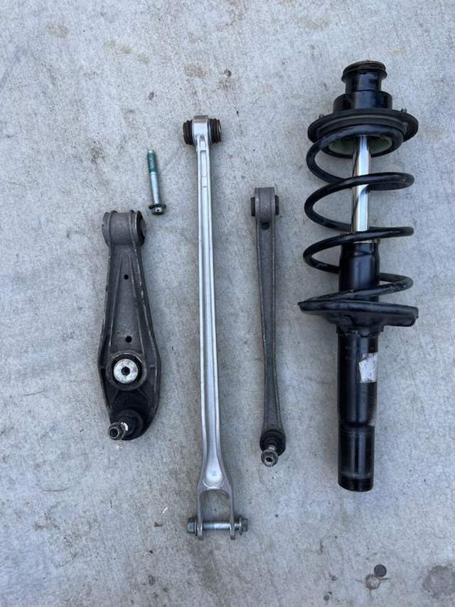

986lp 03-20-2022 05:09 PM
The front right strut was damaged and so I have ordered a new one. I have taken the rear right corner apart and it's not clear what's wrong—as far as I can tell neither the strut or control arms are bent.
What else should I check?
http://986forum.com/forums/uploads02...1647821267.jpg
Boxstard 03-20-2022 06:48 PM
I think you know that camber is adjustable and it may be just misaligned due to impact, instead of something is broken or bent, right? Did the shock get bottomed out when running over a pothole? Arms are aluminum so I’d think it will crack under stress.
