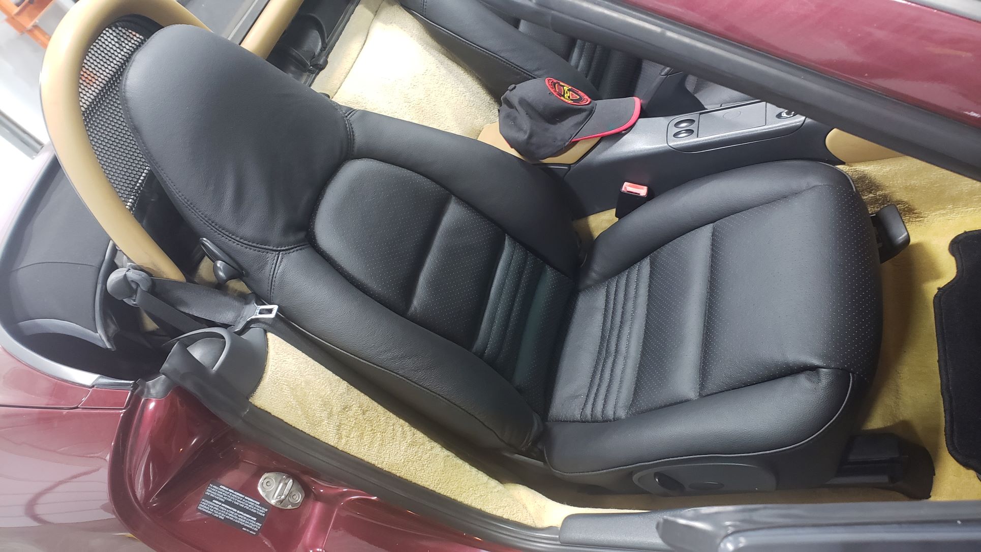

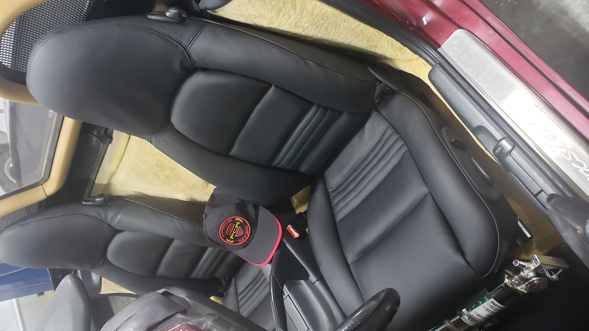

ammonman 04-16-2022 05:22 PM
2 Attachment(s)
Overall quite pleased with the quality and fit of the Lseat covers. While not as high-grade as OE it is still decent leather. There are a few areas where the fit could be better and these may improve with use and some sun exposure. I suspect this wouldn't be an issue if the seat foam was new instead of being 24 years old and a little shrunken. For the price I think it is a great option. I wouldn't go this route for a restoration but for a driver/track toy it is great value for money.
Attachment 23320
Attachment 23321
elgyqc 04-16-2022 08:03 PM
Nice job ammonman, almost no wrinkles. Did you use a heat gun to remove the wrinkles?
ammonman 04-17-2022 05:03 AM
No heat gun yet. Something I've learned over the years working on a few upholstery projects here and there is you have to "give it a lotta love" akin to a deep tissue massage when installing new covers. Massaging the cover and foam in the directions you want the material to lay helps get it smoothed and stretched into place.
BFeller 04-19-2022 01:02 PM
That is one of the best looking installs of the Lseat covers I have seen. It almost makes me want to tackle replacing the seat covers in mine.
