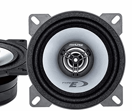

Googling Coax speaker :
http://986forum.com/forums/uploads02/Coax1619016418.gif
Think I will stick to the Alpine that I just ordered.
Stl-986 04-21-2021 01:23 PM
The alpine is what is called a full range or 2 way speaker (3 way also but that just depends). Or for the rest of the world just call it a car speaker.
