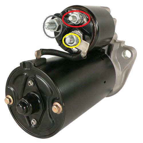

I'm no electrical whiz. Once before I removed the starter... reinstalled it... all good. At that time I was going to correct the Bendix gear screech. Gear popped in and out nicely, reinstalled.
This time... yeah... not so much.
Removed my starter. Cleaned it up... cleaned some gears... got it all back together. So far so good.
Went to reinstall it. Here's the step by step...
Got the starter positioned... top bolt in.
Got the bottom bolt (went in through the front engine cover).
There are two wire posts. One is a smaller diamter post, and to that I atached the funky looking connecter. All good.
For the other post, the larger one... I had two wires to connect. Both fairly heavy duty (think battery cable). One of the wires slipped right on. The other wire took a bit of tugging, twisting, and pulling. Finally got it on... tightened down the bolt.
Reinstalled the throttle body... tightened everything up. All would seem well.
Went to the frunk. Positioned the positive cable to the positive post. When I put the negative cable on the negative post... a nice big spark. Left it on for the 10 seconds it took me to turn on the ignition... no dash lights at all... then disconnected both battery cables.
Immediately came into the house to appeal to the forum for guidance.
I'm not touching the car until I get this figured out. Car is in the carport... in the service mode. Windows halfway down. If I don't get this figured out today I'll throw on the cover... and attend to it in the morning. With your help I'd like to get it back to normal today.
Thank you!!!

Are you sure both of the heavy duty wires go to the same post? Isn't one a ground wire, and the second the battery wire? Please double check the two big wires.
Just a thought.

"Are you sure both of the heavy duty wires go to the same post? Isn't one a ground wire, and the second the battery wire? Please double check the two big wires.
Just a thought.
-EricThe yellow circle was the easy one."
Yes... one of the wires (the one I had to massage on) is grounded to the top of the secondary air pump on the passenger side.
The other wire... from where it originates I don't know... but it was clear it went to the larger post. It fit right on... and I had disconnected no other wires.
"I haven't done this job on my car, but here's the Pelican article on it: https://www.pelicanparts.com/techarticles/Boxster_Tech/83-ELEC-Starter_Replacement/83-ELEC-Starter_Replacement.htm
See pic 5.
I had seen that pic... and it didn't help me at all.
Thank you, both, for the input. I remain flummoxed.
The yellow circle wire was a no-brainer.
The red circle has the smaller diameter post... and that connection came from the left... the wire coming from the small loom with another wire connected to the part that snaps onto the electrical connection on the throttle body.
The grey circle is where I connected the two heavy duty wires (one of wires took some massaging to get on the post).
I don't even want to reconnect the battery. Perhaps I blew a fuse. However, I first have to identify if properly I reconnected the starter. It's not rocket surgery... and it appears the heavy duty wires went where they were supposed to go. I'm lost.
Any other ideas? Thank you.
Attachment 22291
Edit: OK. I see what you're saying, Eric. That wire from where I don't know it comes likely is from the battery... I'm thinking it comes fronm the square box with a positive wire goint to the altrnator. So I guess a new question is:
Should that wire go to the red circle post? That would mean that there's two wires connected to that post. Should there only be one of the heavy duty wires... the ground wire coming from the top of the secondary air unit... connected to the larger post? Should there NOT be two wires connected to that larger post... and I was incorrect trying to put both heavy duty wires on that larger post? That would mean that I connected both a ground and positive wire together... and on the ground of the starter. Should there be two wires connected to the red circled post?
Since I had no dash lights wafter the battery sparked... which fuse should I be looking at?
Hmmm. I'll wait for a response from anyone.

When you were tugging on that wire, you potentially shorted it to ground. You'll want to start there. Indirect that wire it's full length.
Oh, but first: I've often seen the round loop connector get chocked just-so, and it touches the body of the starter or solenoid. Check that first.

Thank you, Maytag. I figured it out...
I watched a couple of vids, again... and discovered my error...
The ground wire I "massaged" onto the starter... HUGE error. That wire I was supposed to connect to the bottom bolt connecting the starter to the motor. Damnit.!
So... I'l pull off the TB... remove that bottom starter bolt... and affix the ground.
That inspire some other questions before I return to the car...
Do you believe I damaged the starter by connecting the ground wire to that larger post? It's clear to me, NOW, that I connected both a positive and nagative cable to the starter.
The dash lights didn't come on? What do you think happened there>
So... should I get everything back in order... affix the battery cables... and turn on the ignition waiting to see if I have dash lights or... are there some other steps I should take before I tackle everything.

You're probably okay. There are risks, but most systems are pretty insulated from a major fault. You'll know soon enough.
No other steps to take.... except finger- crossing, which we can all handle on your behalf.
Usually, in my experience, with a dead short like that you'll let the smoke out of the wires first....
Fingers crossed.
I doubt it damaged the starter, but most likely it fried a main fuse somewhere, or a fusible link, if these cars have one. The 'big spark' you mentioned in the original post was a big red flag for me. That's why you got no dash lights.

I'm going to pull off the TB... disconnect fron the starter the ground wire... so at least I can close up the car... assuming the "spark" didn't blow a major fuse.
Hopefully when I get back in the house I'll have some more guidance from you Pros.
Thanks, Man!
Starter986 03-27-2020 03:18 PM
OK. Removed the ground from the positive post.
Battery connected... dash looks like its usual setup. Chime... all lights... whew.
Now I go struggle with getting the ground on the bottom starter bolt... zip everything back up... and we'll see.
Thanks, all, for the guidance.
So far. ;)

If your second heavy wire has a flat lug with a notch in it, it should bolt onto the red circled bolt. It should only fit one way, the notch positions it. It is position so it can’t touch the other large wire from the battery (black box you mentioned).
Let me know if I can clarify further.
