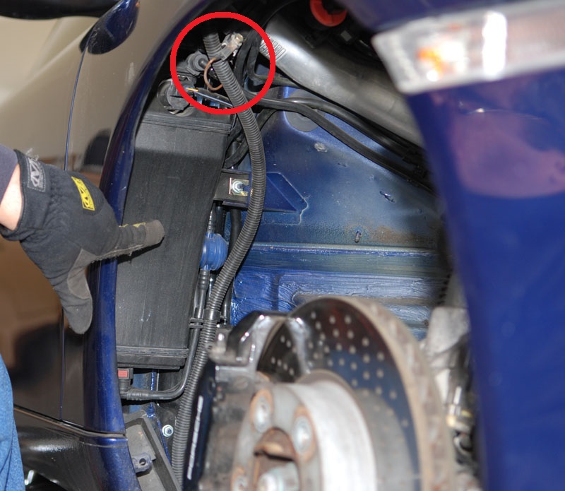

The actuator it tucked up behind the EVAP canister. You have to remove the EVAP canister to even get to the actuator. However if the wheel liner was removed I would check the wire I have circled with red in this picture to make sure it didn't get unplugged.
https://i.postimg.cc/vHjX6Y5g/1179360338.jpg

KRAM36 11-16-2019 07:41 PM
AFAIK, the fuel door lock is tied in with the door locking system. So if the door lock fuse is working, then the fuel door lock should be working.
