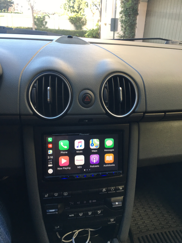

After connecting all the wires and connectors, I wrapped some electrical tape around the whole bundle to protect the wires and I zip tied it. I originally was going to run an HDMI cable and RGB cables but there is so little room behind the stereo that I took them out. It is a tight fit. The bezel I got from Crutchfield came with a 1 DIN cubby that I didn't need and I had to shave off a couple of tabs but then I inserted the radio and everything worked:

My backup camera by default reverses the picture which is the correct orientation for my Pioneer stereo. My backup camera came with a wire you could short to put the image in the opposite way but I didn't need to do that. My Pioneer has a system setting where you can check the GPS strength and my mounting location is excellent (16-19 GPSs green and others are yellow). I turned on the headlights and my unit dims. I didn't hook up the video HDMI and RBG audio video cables because even if I use these in the car, the Pioneer unit won't show video when the parking brake isn't applied. Also, the space behind the unit it tight and I initially couldn't get the stereo in until I wrapped the wires and zip tied them. I also tested the speed sensor monitoring on my Pioneer and it shows a count that increases at the car speeds up and decreases as it slows down but it does not show mph. It shows a value like 3000 for 50 mph (or something like that). This is normal.
