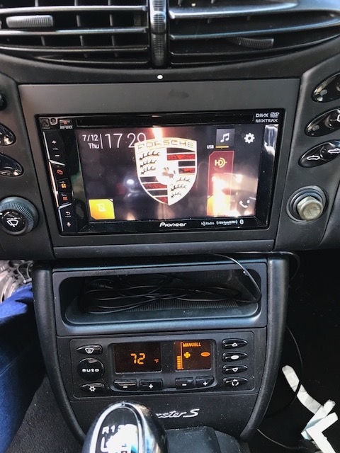

Just went through this and also have the six speakers, factory amp, cd changer..etc. I changed out the head unit with a double din pioneer and integrated the factory amp. It might take a little more then basic audio skills, but I found it extremely easy.
Ill post pictures in this thread.
There are four pre-amp outputs that I used from the rear of this unit and they send sound to the door subs and the front/rear speakers. Changes to fader front to rear work as expected and the subs thump.
REMINDER: in this car, yellow is constant power and Red is switched...get that wrong and you lose all your setting every time you remove the key, gotta pull out unit and swap em.
Car Audio Innovations website is helpful and if you want to buy a kit, their prices on the HU stuff are competitive. Harness stuff is fair. Consider it at least. I just used the advice to make sure I didn't make mistakes.

I tried hard not to get carried away and bought modestly priced consumer grade stuff for the project. It is fantastic, sounds fantastic and I have no regrets.
I selected the Pioneer DEH-X4900BT, and strongly considered the Kenwood DDX795BH. Most any of the Head Units are ok, you need to decide what features are important. I wanted to integrate wade into the head unit via the pioneer app and cheat a navi system out of it, but honestly, this is clunky and doesn’t work consistent. (worthless)
I have BT, Spotify via BT with control, (Man did my data consumption go up…:+)), USB (I stashed a 256GB SS HDD under the dash with thousands of songs in nice little folders) and put the parking brake hack on the wires so the DVD works without having to tie in the parking brake. I never intend to watch a movie when driving, but tying into the parking brake was a PIA.
Note: Choose the appropriate one for you head unit, but: “Micro Bypass ALL AVH-X Video In Motion Interface for Select Pioneer Receivers”)
My car had 2 speakers behind the seats and I upgraded to 4 speakers using 3-1/2” Infinity References using the stock harness. I bought euromotorspeed’s “1997-2011 Porsche Boxster Custom Rear Speaker Bracket Set” off ebay to fit them.
Front speakers were swapped to Alpine 4” SPS-410s (a bargain and great little speakers.
I replaced the Door Speakers (SUBS) with Pioneer TS-G650. I modified the stock baffle boxes to accommodate the switch from 5.25. (this is time consuming, but I'm a craftsman…looks and sounds great)
