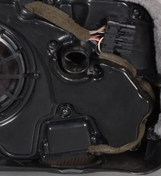

Does anyone who has done this happen to have a wiring diagram of what the wires at the connector of the speaker shelf are?
