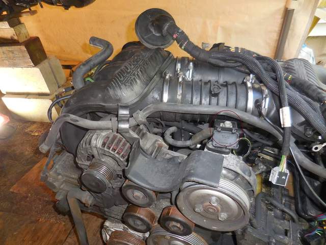

The electric box on top of the front of the engine circled in red. i have no power there. I rebuilt the engine and maybe i did not connect the power correctly when i reinstalled. Should it have constant power? its connected to the starter and alternator. http://986forum.com/forums/uploads02...1477753135.jpg

starter issue is resolved. when i cleaned the power distributor i forgot to attach the main cable that went to the engine... hence no power to the starter. working now. i did send the immobilizer out to get it checked.
