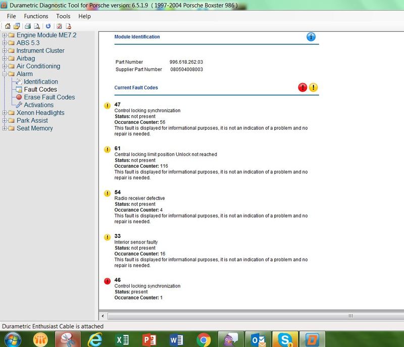

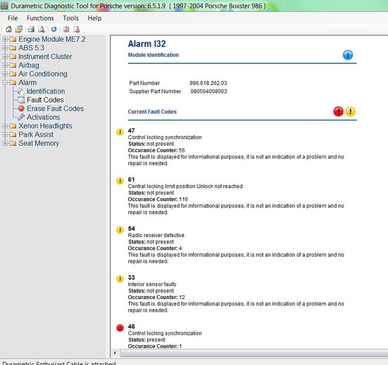

jpc763 07-13-2016 03:17 PM
So it has happened 3 times today! :mad:
Here is a screen grab of my alarm codes from June 2.
http://986forum.com/forums/uploads02...1468448205.jpg
And here is a grab from just now.
http://986forum.com/forums/uploads02...1468448226.jpg
The only code that has increased is code 33. Ideas as to what sensor that is?
Thanks. John
JFP in PA 07-13-2016 03:44 PM
You have multiple faults, including the interior sensor (motion sensors above the mirror) and the radio sensor (a ground on the factory radio chassis).
jpc763 07-13-2016 03:51 PM
Thanks Jeff. I have done some searching and found a thread on another forum where a sun shade was causing the interior sensor to go of. I bought one a few weeks ago and it was just before this started. So, I will be looking into that.
On the radio, I did replace the head unit and I thought I correctly reconnected the ground. Can you tell me what wire I need to make sure is grounded?
Thanks, John

JFP in PA 07-13-2016 06:31 PM
Thanks, John
There was a ground wire (brown in color) that was attached to the metal frame that the factory radio made contact with when it slid into place, that is the one you need to fix.
