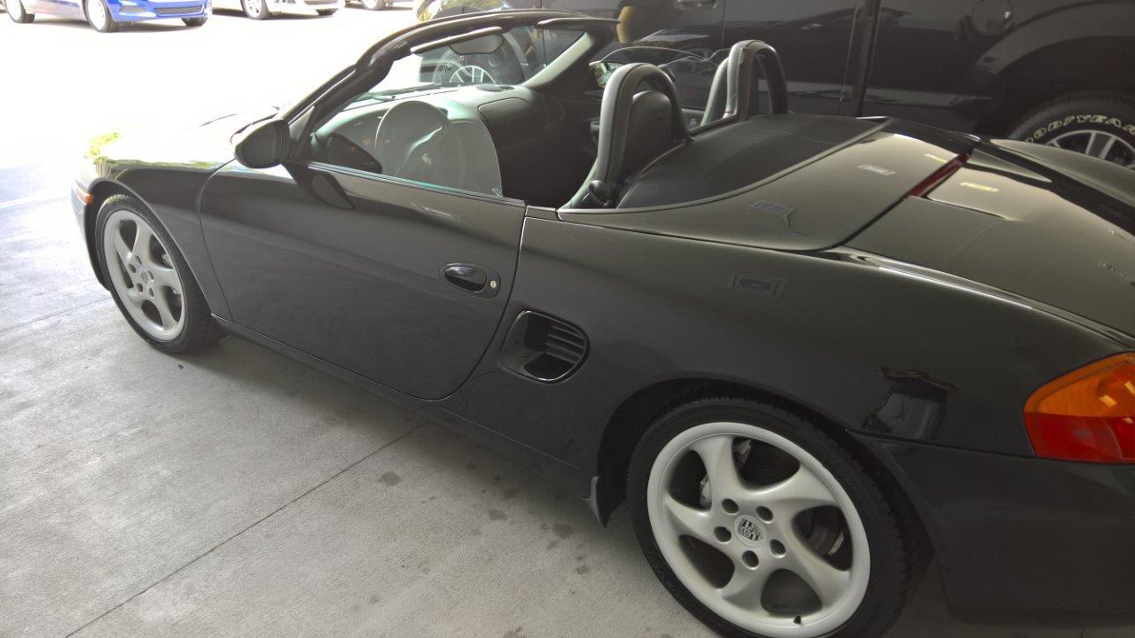

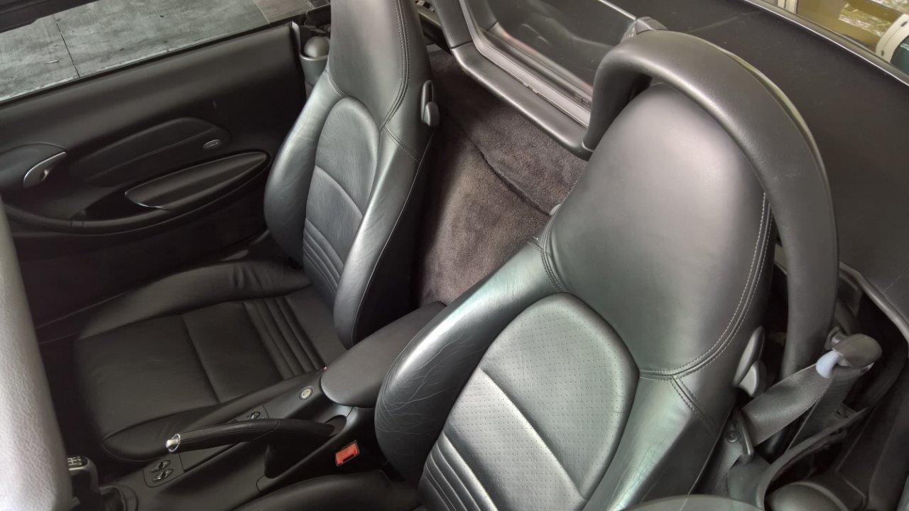

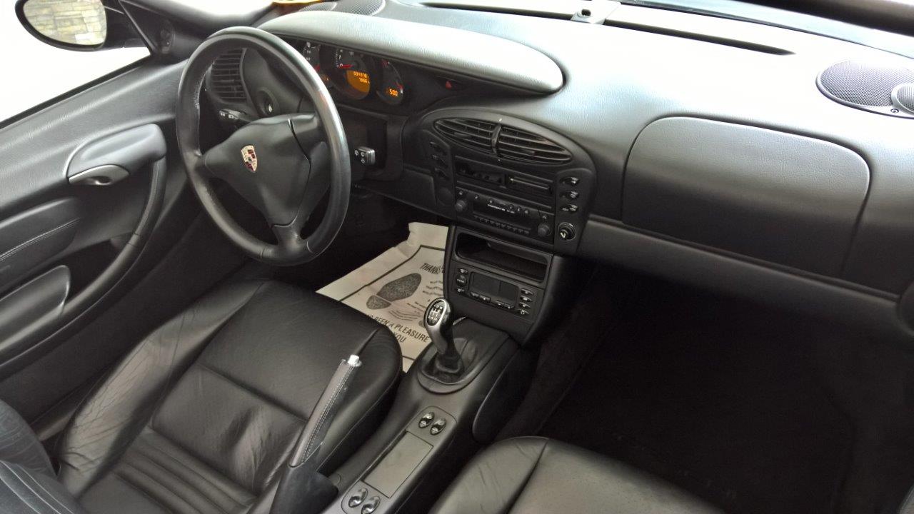

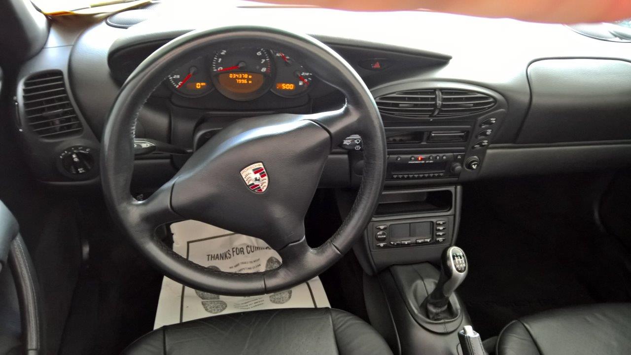

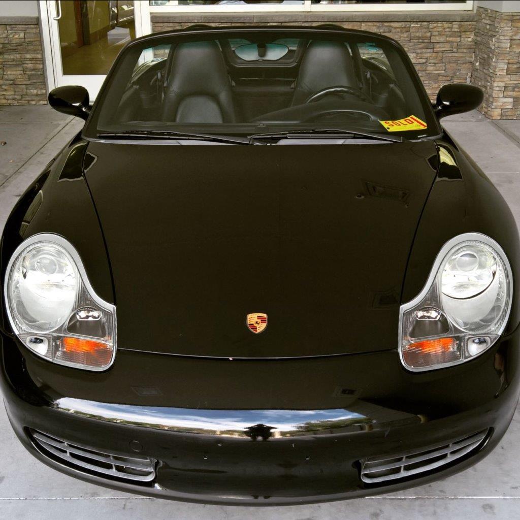

Wow, I'm honestly surprised at the number of replies I received. Sounds like this is a great community. Here are some pictures. All it really needs are new cup holders.

Great looking car.
