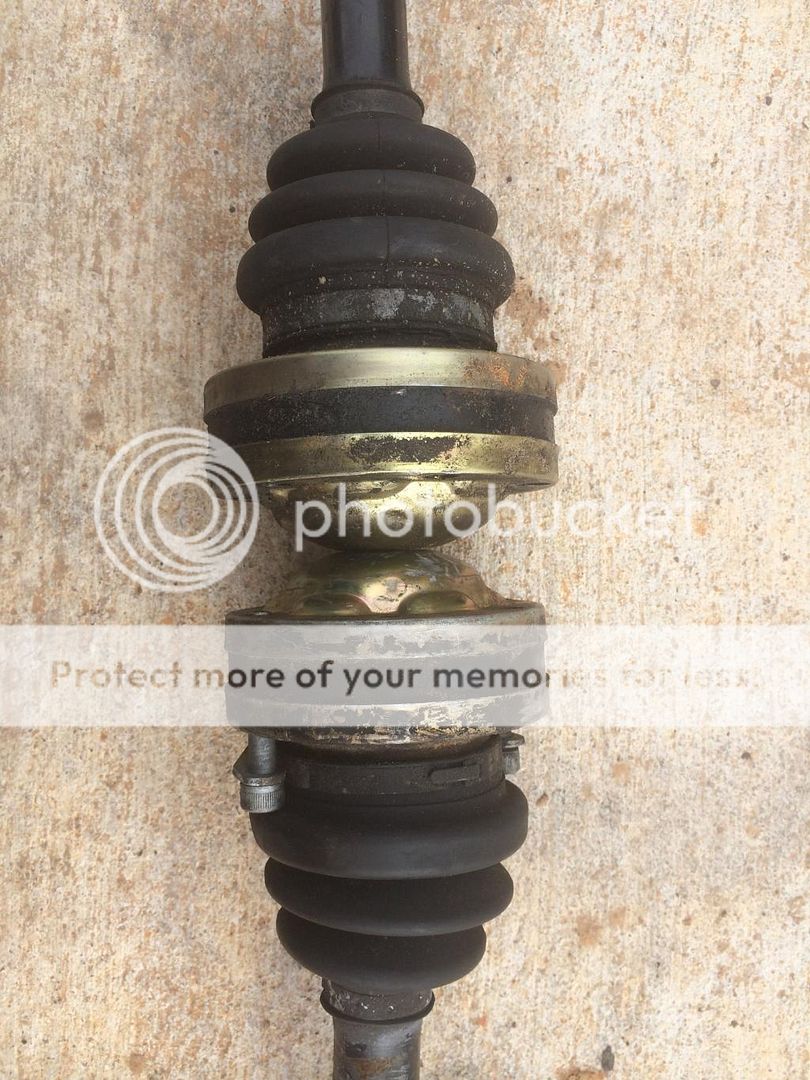

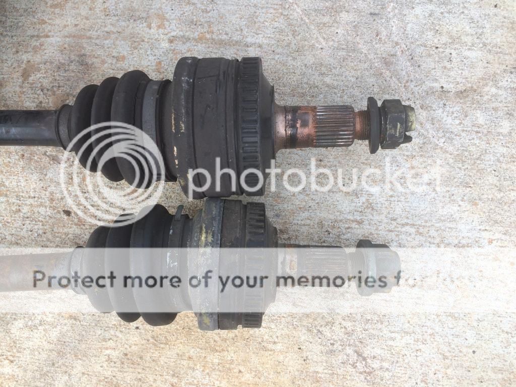

http://i765.photobucket.com/albums/x...pseveroanq.jpg
http://i765.photobucket.com/albums/x...psdq2bjwdf.jpg
Yes. 5 vs 6 speed axles. The 6 cv joints are much beefier than the 5 speed and the 6 speed are longer because the 6 speed sits farther back. The 6 speed axle also wound not fit inside the 5 speed upright without milling the upright to fit the massive 6 cv joint.
