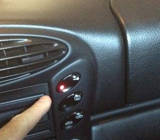

jpc763 02-22-2016 02:29 PM
I wanted to update this with another piece of data. I may be confusing people with the terms I am using. When I talk about the alarm light, I am actually talking about the lock indicator light. Here is a pic.
Attachment 20091
When this light is on, the window will not drop and I get the double honk when unlocking the car. It seems to happen when it is warmer out. It also goes away after a period of time.
