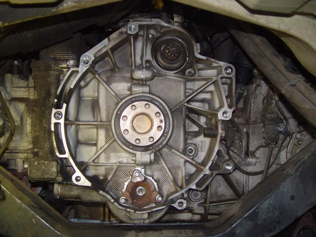

James and Team,
Any suggestions on how to remove a stuck IMS Bearing cover? See attached pic. There was no oil leaking but the cover is a bit rusted and not budging with a set of flat screw drivers. As you can see I most likely have IMS bearing issues as the nut and part of the bolt have fallen off.
Since I don't have the tool for removing the cover that the Porsche technicians have I have to devise something to help me remove the cover to get to the bearing...:)
Any help will be much appreciated. http://986forum.com/forums/uploads01...1422291879.jpg
http://986forum.com/forums/uploads01...1422291904.jpg
PS. I have also posted this request in the TX removal thread that I was part of as I had asked the question on how tight the TX bolts can be expected to be. Got the TX out without any damage...now the cover...one small step at a time...
flaps10 01-26-2015 09:53 AM
I might remove the three bolts holding the cover on. Probably speed things up quite a bit
PorscheFan5 01-26-2015 09:55 AM
...Removing the cover after removing the star bolts of course...:)http://986forum.com/forums/uploads01...1422294903.jpg
spendy 01-26-2015 09:58 AM
You might want to try tapping sideways on the 3 ears with a hammer to rotate the cover. That might break it loose and make it easier to pry.
PorscheFan5 01-26-2015 10:45 AM
Thanks Spendy.
Looking at another picture posted by nmdarby that was my exact thought today morning. Will try that. It seems the surface is flat so twisting it in its vertical plane will at least break it loose and also then provide me with a surface to get the screw drivers under to pry it off.

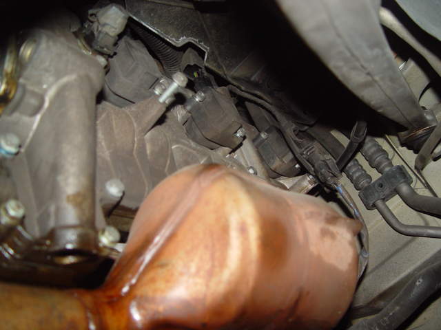

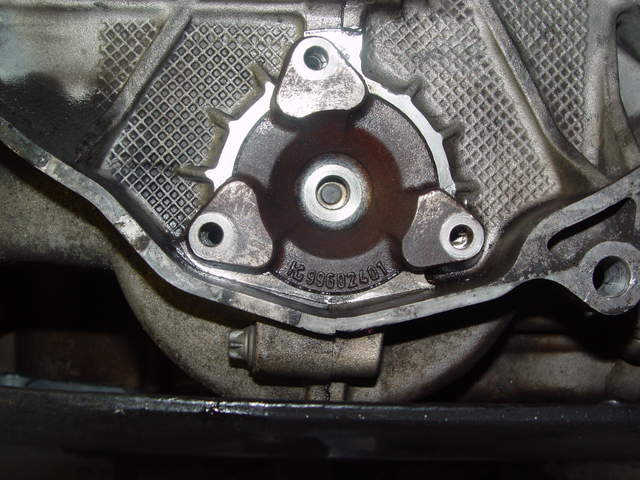

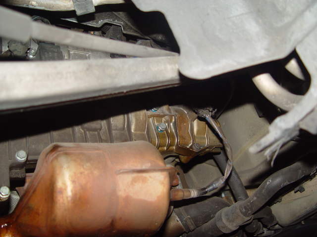

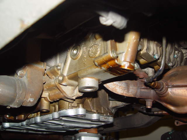

Having removed the rear parts including the TX, as I looked over the engine, I see that the dealership that the PO took it to have removed and replaced (rnr) the Cam Covers. See attached pics where you can see loose bolts on the Cams and also Coil 1. My questions are these:
-- Is anything missing there as much as you can tell from the pics? In pic 3 are those the Chain tensioners that are protruding down? Are the tensioners (the things we remove to loosend the tension on the Cams/chains) missing? I have to get my bearings properly on the components of the engine...
-- Since I will be getting the engine to TDC to remove the IMSB, does it make sense to remove and reseal the Cam covers at the same time? Or I should handle the two separately? I already have the Loctite 5900 that I bought to reseal the Oil Pan/sump and it works well. I know the tool for locking and holding the Cams are different as stated by some people on the threads...Note there is no oil in the engine at this time and what you see is the residual oil leaking from the engine...
My plan/thought is that if the engine is too much work that I cannot handle as DIY, I will just forget about it and just remove it and continue with my electric project. However I want to do my best and see if I can make the engine work. In the process I don't mind spending some money and my time. I am in no hurry and get to (love to) work on it in the weekends.

Photo 3 looks like the hole for one of the tensioners, but the tensioner is missing (not unexpected when a dealer is doing a diagnostic tear down to figure out what failed):
http://www.pelicanparts.com/techarti...mall/Pic16.jpg
I'm not exactly sure where you are thinking on going with this, but if the IMS has failed, you cannot just install a new one and retime the cams. The engine will be full of fine metallic grit, the cams have probably jumped time, and some of the valves are probably bent as well.
That engine needs a complete tear down and rebuild.

from what I can see in photo 3 that is not a missing chain tensioner. The engine is symmetrical up to the point of casting in bosses that are machined on one side and not the other. The boss in picture 3 is on the right head and doesn't do anything. The same boss on the left head is machined and has a chain tensioner in it,
