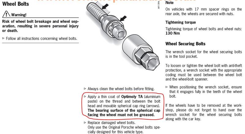

Nope. The porshe manual has specific instructions for lubricating the lug bolts. Id especially do it if you are driving in the winter with salted roads. Much easier to get the lugs off later.

Porsche is somewhat alone in recommending lubrication on wheel bolts.
Mercedes forbids it and BMW does, too.
I had no idea Porsche recommended this! Once the snow stops falling ive got to resume my fall/winter maintenance.
