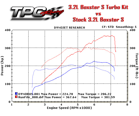

DarkStar 09-27-2015 06:37 PM
10k for 320hp to the fly... a prime example of fail. The Boxsters 3.2 can be turbocharged to produce much more for less. Even the expensive TPC Turbo kit is ubder 10 grand, and has room for lots of extra.
Attachment 19765
