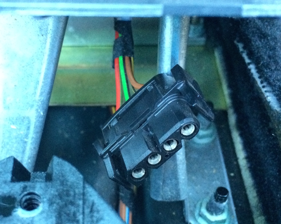

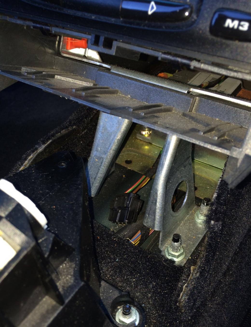

Yesterday I removed my center and dashboard consoles for a paint project and noticed I have an extra connector which is not connected to anything (see pictures bellow). Any idea what this is for (I have a 2001 Boxster S)?

Here are the photos:
Attachment 18623
Attachment 18624
amagalla 06-18-2014 10:43 PM
This is the phone accessory plug. It provides both constant power and switched power. I'm using it in my 04 to provide switched power for my new head unit.
