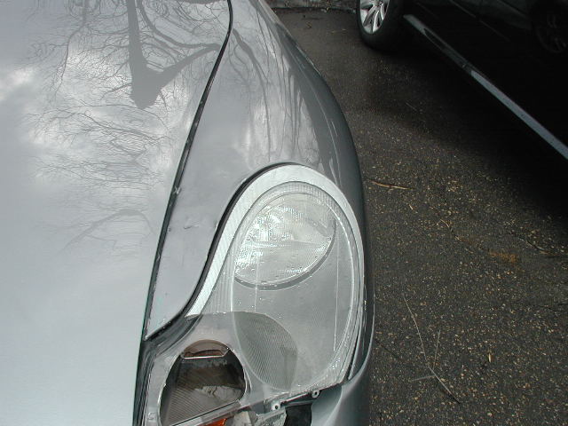

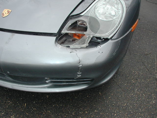

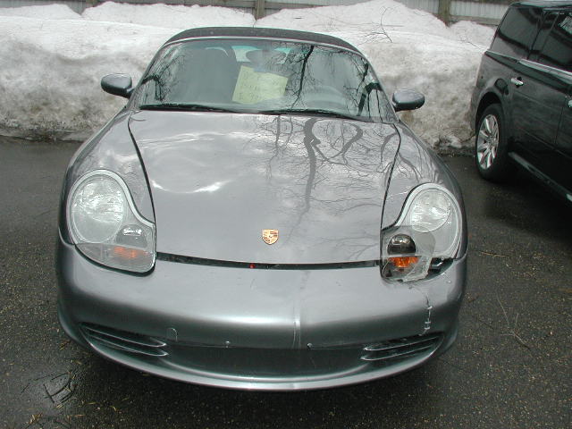

It is an 03 Boxster. In my fav color, with the options I want. 75k miles on it. He is asking $8950. I have already talked him down to $8000!!
But, the problem is in the picutres. So the question is would you buy this car at a good price, and get the body work done, or look for something else? I would have to pay someone to do the work.

particlewave 04-03-2014 01:05 PM
You are looking at a $3000 repair bill, easy. Probably more, depending on what the damage looks like underneath that front bumper cover where the radiators and condenser coils are.
I would probably pass on this one unless you know exactly what you're getting into. Personally, if I inspected it and found nothing more than body damage, I might pay $7k.

There might be more than just body work involved with repair. Behind the bumper are some other components like one of the condensers and one of the radiators.

Could have bent the frame with an offset crash like that since it's not where the actual bumper is depending on angle.

husker boxster 04-03-2014 03:23 PM
Keep in mind that a good portion of the membership will freak out at a fresh rock chip, so asking if they'd buy a rebuilder may result in tainted answers.
Porschebound has given you a very good ballpark estimate. Mark_T's advice is spot on. My advice is how comfortable are you with a rebuilder? If you've done them before and had good luck, then by all means go for it. I'm a bit concerned that you'll have to have the work done for you. Then you need to find a quality shop to do the repair and it will cost you more. If you were able to do the work, then you could cross off the labor expense and you'd save some money. And how long do you plan to keep it? The longer you keep it, the easier it will be to sell it. But keep in mind when you go to sell it that you'll have to discount it. Many buyers won't even look at it if it's had a major repair. As I stated at the beginning, Porsche owners can be very particular. If you plan to repair it and then drive it for years to come, then you don't need to consider resale, but it's wise to look down the road a few yrs.
A 2003 is a good model to buy since it has desirable options like a glass rear window and a glove box.
It would be good if you can obtain a pic with the hood open and we can see if there's obvious damage to the inner construction.

You need a front quarter panel, hood, bumper, head light, bumper reinforcement, radiator, radiator fan and possibly more. You can get all of this stuff cheap on eBay in the US. The most expensive part will be painting. My worry is that the radiator was damaged then driven, then over heated, and cracked head or blown head gasket. Check the oil and coolant and make sure the colors are right. If this car was in the US I would offer $6k only if the oil and coolant were fine.
Looking at the pictures again the fact that the bumper was ripped in two and needs to be stapled leads me to believe the damage is worse than it looks. It's easy to check though, drop the bumper in less than 30 min and you'll know what you have.

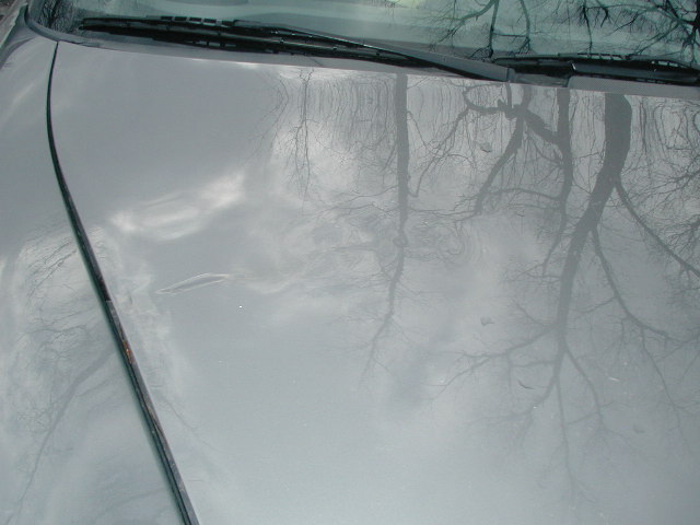

It may just be the sprung hood, but the thing that worried me most was all the panel gaps. The service manuals have exact measurements for the gaps between panels. They are uniform and they are straight. I see gaps that get wider or narrower and I wonder how deep the damage goes. Definitely get this inspected by someone who knows what to look for on a Boxster.

I was thinking the same thing too when I first looked at the pics. It might be the gaps look wide because the hood isn't latched.
And remember if you were buying all new parts, you'd run up a big bill. If you take your time and search junk yards or ebay, you can find a headlight here, a fender there, etc. Parts will cost you a lot less then. This is the point runjmc2 was making. My guess is Lobo's repair used new parts, which he should demand since it was someone else's fault. You should be able to find used parts for an 11 yr old car.

I thought the hood looked warped.
