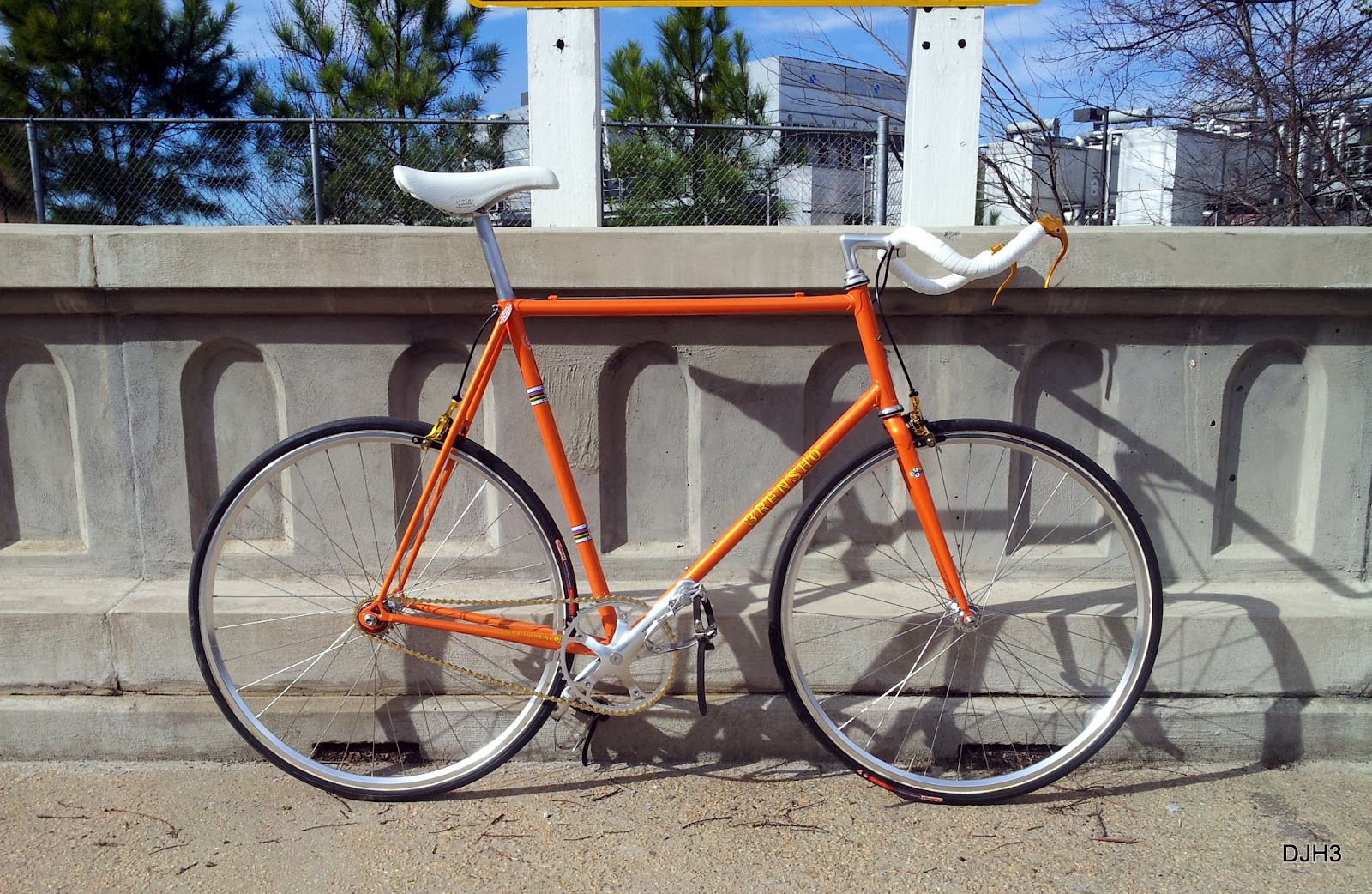

Hey san rensho - happen to have a 3Rensho?
Here's my restored 86:

Yes I do! I got one of the first to come from Japan, but its a restoration project at this point. I need to find an old campy group to bring it back to its former glory.
Yours looks great. Nice conversion. SS or fixed.

thanks for the update and may I say- I love that bike, including the colour!
