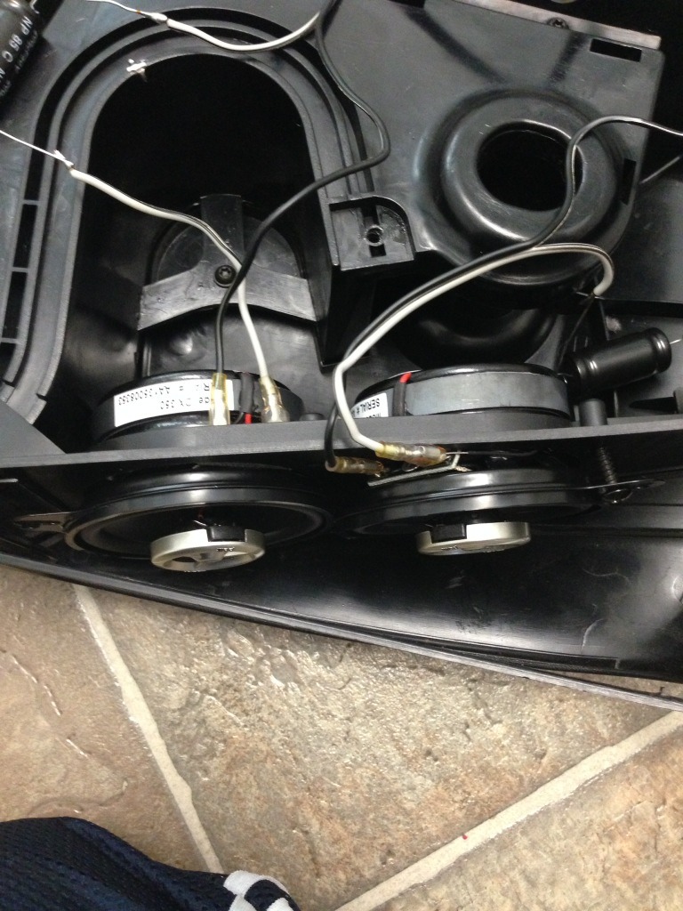

tomonomics 10-31-2013 09:12 AM
Are those OEM mounts? (I've never seen a stock rear speaker setup). Edited: Below is a close up pic of the speakers and mount.
These may be the same speakers in the kit: Pioneer TS-A878 3 1/2 Inch 60W ($35 per pair on Amazon).
If so, the $250 premium over the speakers themselves is a lot to pay for the mounts, grills and wiring. I've already replaced my Bose head unit and front dash speakers, which made a huge difference. Door speakers will get replaced in the next few weeks.
