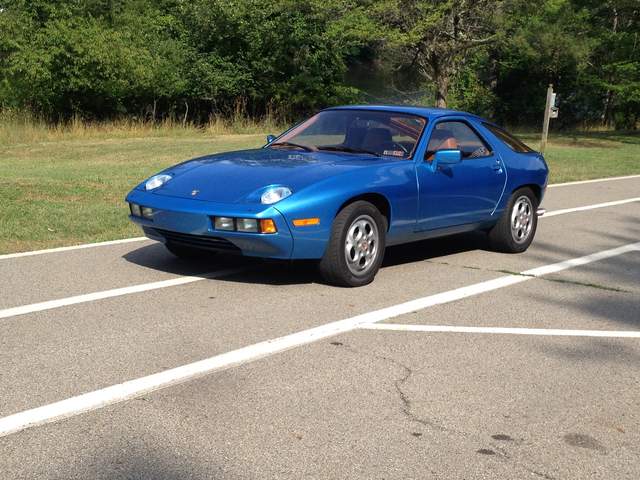

Love the phone dials on the Box. Now you have me thinking for my Boxster. Here is a set on my shark.
