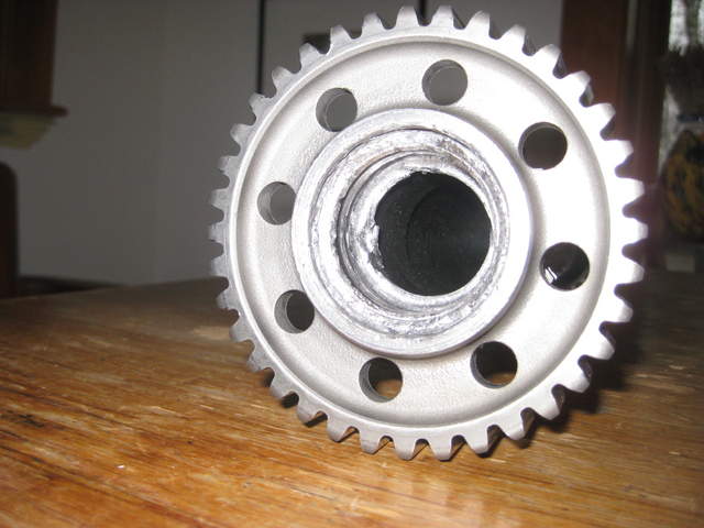

Below is the IMS I sent to LN Engineering with a view of the beat up bearing race.
http://986forum.com/forums/uploads01...1380374827.jpg
http://986forum.com/forums/uploads01...1380374863.jpg

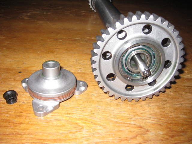

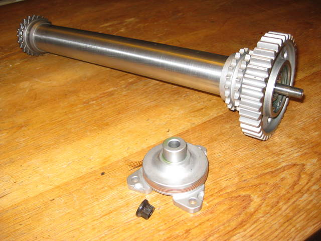

Below is the rebuilt IMS and a view of the new IMSB. This is how I received it back from LN Engineering (well the flange was actually attached to its stud but that hides the bearing for a pic.). If you could enlarge the photo you can actually see the ball bearings and see they are not sealed.
http://986forum.com/forums/uploads01...1380375177.jpg
http://986forum.com/forums/uploads01...1380375218.jpg
