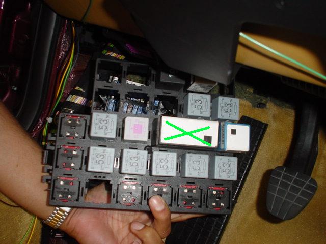

You can get electrical contact cleaner at Walmart or any auto store. The top control relay looks like a large (double sized) relay toward the top right of your fuse panel. It will have a white label on it.
Pull out the top control relay and spray the electrical contacts with the cleaner. You can also spray into the relay socket in the fuse panel. A little spray is all you need.
Give it a shot. Make sure the relay is fully seated in its socket when you reinstall.

Thanks for the help. I have located the unit. Do I just pull it out of the tray? I have pulled very hard on it and it doesn't seem to budge. Short of getting both hands in there and yanking as hard as possible, I'm not exactly sure how to get it out.
This is the unit, correct?
http://www.renntech.org/forums/uploa...1084760371.jpg
eli cash 09-08-2013 06:09 PM
Nevermind! I quit being dainty and ripped that sucker out. Pulled out the little white one next to it first to get a better grip. Cleaned the contacts and now the top works. Still need to see if it is persistent in coming down over the next few days, but this is definitely a good sign.
