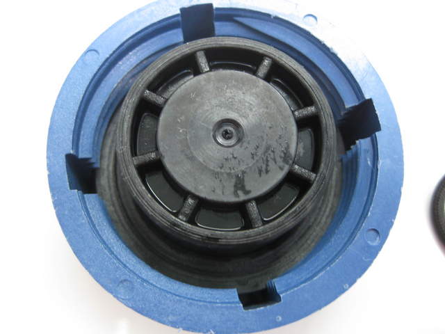

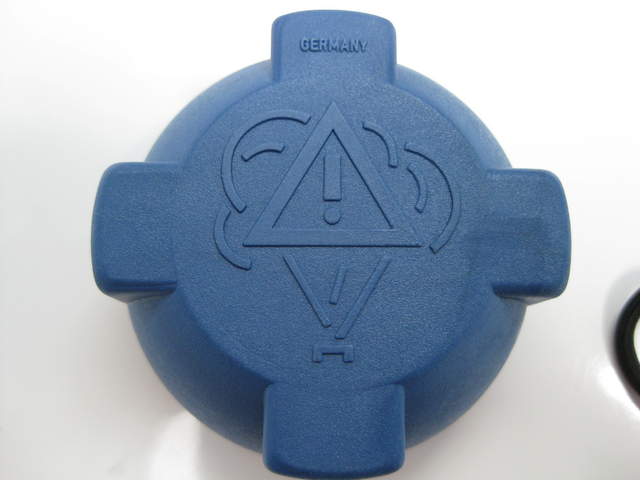

Originally Posted by l3m (Post 356512)
Here's a pic of the latest coolant cap. I replaced mine last month after I noticed a slight drop in coolant level.
http://i241.photobucket.com/albums/f...ps586b280c.jpg
http://i241.photobucket.com/albums/f...psdf33d828.jpg
Interesting. My -04 cap looks nothing like that...
http://986forum.com/forums/uploads01...1377123690.jpg
http://986forum.com/forums/uploads01...1377123702.jpg
ekam 08-21-2013 03:39 PM
Could be a VW cap ? I'd replace it asap.
clickman 08-21-2013 03:45 PM
Not VW. See my post above, where I show the bag with the correct Porsche part number. And I bought it from a well-respected indy. And apparently I'm not the only one with one like this...
ccjazz 08-21-2013 03:45 PM
I agree with ekam. Maybe you picked up the wrong one. Got mine from the dealer recently and it's identical to the top one pictured.

ekam 08-21-2013 04:44 PM
Either way, get the OEM one direct from the dealer - order from Suncoast or Sunset, both ships to Canada.

Perfectlap 08-22-2013 09:18 AM
Originally Posted by clickman (Post 358588)
I also got my -04 cap like this from a respected indy. The tag on the bag looks genuine, so hopefully it's ok. The missing part number could be an annoyance down the road...
http://986forum.com/forums/uploads01...1377108125.jpg
I have the same. No part number on the cap. Weird. My indy strongly favors using OEM whenever possible. Maybe this is new VW takeover stuff...
suppliers are not being directed to follow part numbering protocol strictly. But that meshy thing on one and not the other seems weirder.
