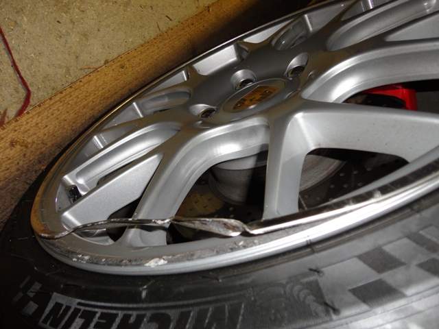

But not as stupid as what ELSE I did today, which is rub one of my beautiful month-old CH-Rs against a Belgian block curb. Curse those Belgians! The stainless rim protector did it's job, and the wheel itself only took a tiny hit, but the protector is toast, in the way only stainless steel can irretrievably bend.
Now I hafta find out how to get a new protector on there. The Tire Rack told me that I could NOT buy extra protectors, since only BBS in Georgia would be able to mount a new one, but c'mon, it is just a metal ring clipped on and backed with foam tape. Shirley, they can't be serious. I guess I'm gonna find out.

Here's a pic of today's damage. It looks worse than it is in this pic. I can peel-off the protector without a problem I think. That foam tape is going to be a pain to remove, though. I have Goo-Gone, which works painfully slowly. The only REAL damage to the surface of the wheel can be seen under the curve of the wrecked protector.http://986forum.com/forums/uploads01...1370047549.jpg

I've now removed the wrecked rim protector, and I was wrong, it is not clipped and stuck on with tape, it is actually only stuck on with the dreaded foam tape. I got the tape off with Goo-Gone worked-in with a toothbrush and a LOT of rubbing of gooey foam. Uck!
I've contacted BBS about buying some more rim protectors, waiting for their answer.

Just to finish off this thread, BBS in Georgia does indeed sell replacement rim protectors for $54ea plus shipping.
