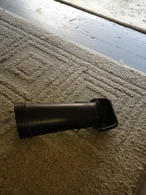

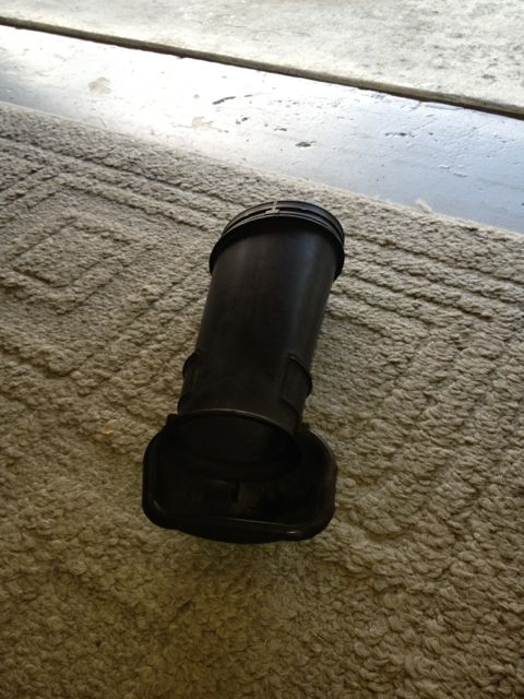

tony_fury 10-31-2012 04:56 PM
2 Attachment(s)
The Snork...
I was surprised what it looked like until I removed it..
Attachment 16745
Attachment 16746
Ghostrider 310 10-31-2012 05:01 PM
When I had a 986 I just took off the holy water blessing cup at the end and replaced the trumpet horn. Many cars I have seen over the years had that same inlet, including a lot of air cleaner inlets, the 396 SS had it. If it's been used that long the design must be well established as the way to increase inlet volume. As for homeboy, I'm glad you made a mod you are happy with but it's a little hard to believe just that mod made it "scary fast".
Eric G 10-31-2012 05:28 PM
...sorry to burst the bubble, but all Boxsters are cold air intake, desnorkling allows for more air flow, but all of our cars are "cold air intake" designed.
