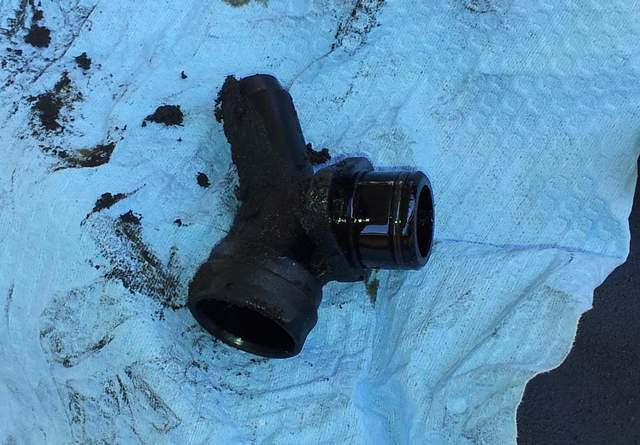

after replacing the AOS a second time it looks like I may have found the real problem.
there is a over pressure valve in the system that of all things vents to atmosphere!
If course it is not called that.
Lets see if cleaning it will help. It was all clogged up. This is why you change your oil and often.
http://986forum.com/forums/uploads01...1347128943.jpg
