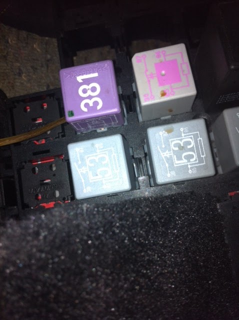

I'm trying to do this "Fog lights as DRL" mod from the DIY forum:
Anti-Bling Porsche Boxster DIY's
According to the author, I need to tap fuse "A7" with the purple relay shown in the picture below,
Anti-bling: http://2.bp.blogspot.com/-WCW_TuqpWC...wg/s1600/DRL+2
However my relay arrangement seems to be different to the picture in anti-bling's blog,
Mine:http://i235.photobucket.com/albums/e...0120730419.jpg
Purple replay missing.
I suspect this might be due to model differences between Australia and the U.S. However. Australian spec Boxster should be the same as Europe (or ROW?), is this correct?
- How do I find out which relay of my Australian model 986 is equivalent to the purple relay of the U.S. model?
Appreciate any help
:cheers:

Thanks for the post. I found the thread from ppbb you are referring to:Daylight Running Lights using Fog Lights - repost, tx Rich in CT
My problem (as posted in the OP) is that relay #12 is missing in my Australian spec Boxster. It's the empty socket to the left of the pink/white relay in the picture, see:
Anyone has any ideas?

So does anyone know the fog relay location of non-US Boxster?
particlewave 08-09-2012 12:01 PM
Do your fog lights come on with the switch? I'm a little confused about this one. I found a site that lists the relays and, of course, it lists #12 as the fog light relay, but specifically says "USA/Japan".
I'm wondering if non US 986's even have functional fog lights? If not, it may be as simple as inserting the proper relay into socket 12. If yours do work, I'm stumped.
That site absolutely did not list a non US fog light relay, but did list #6 and #7 as daytime running lamps.
Can you confirm that your fog lights work?

panameras 08-10-2012 08:06 AM
Just found out from renntech that RoW cars have fog lights that can be turned on anytime (with parking/city lights, without the headlights) whereas US, Canada, and Japan laws require them to only be used with the headlights.
Didn't know there was this difference in how fog lights operate.
So #12 is the fog cutoff relay which ROW 986s don't have. Any ideas on how I can make fog lights come on with ignition?
