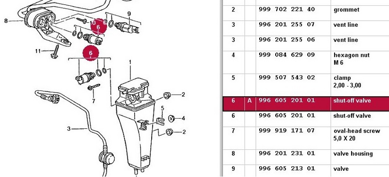

Shut-Off Valve. I have that whistling sound coming from the passenger side while going over 45+ MPH. Researched and found people have fixed that problem by replacing this "Shut-Off Valve."
Part # 996-605-201-01
So I believe this part will do the trick, anybody have experience with this?

Attachment 16338
Here is the diagram as well.

There are two valves in there that look similar. OEM-99660521301 is the one that fixed my whistling sound. You need to remove the wheel and the inner plastic liner to get inside there. Pretty straight forward job. The little plastic retainer things that hold the liner on can be a little hard to remove. I loosened them up with some p-blaster and had better luck with them.

I have the flute too. I've been putting off fixing it forever. From all the research I have done on several forums it could be 1 of 3 of the parts in that picture. I don't think all whistle/flutes are the same. I have been able to reproduce sitting still so I'm going to take covers off and narrow it down to the exact part.
bar10dah 07-02-2012 04:55 PM
I replaced the bottom #6; the one on the EVAP canister. Fairly easy to do with the fender liner out. I never looked at the top #6, so can't be sure how to access it.

Mine had the whistling sound until I took out the Check valve (96.201.255.07 and 96.201.255.06) and fashioned my own check valve (the check valve wasn't doing its job and was letting air in both ways). It stopped the whistling but I'm pretty sure something else is broken which caused the check valve to break.
