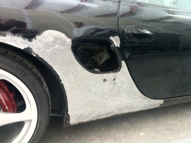

RandallNeighbour 03-03-2012 02:07 PM
Thought you all would like to see the progress being made on my car. They've pounded out the panel and ground off all the paint. I pointed out that the panel still needs work though because the seam in the panel and the door widens below that vent and it's too close above it and below it.
Notice the two rust holes just under the vent. Those will be cut out and metal welded in its place to remove it completely. I'm really happy about that.
And wow, the car looks so naked without the rocker panel on it. The insurance company is paying for it to be repainted as well just to make sure it matches. Nice!

gerrynoank 03-05-2012 05:20 AM
Not trying to de-rail the thread but what seems to be the cause of the two rust spots under the vent? Just wondering because I have two identical ones on my 2000.
Ghostrider 310 03-05-2012 06:23 AM
Gerrynoank, Mine had some small bubbles in the exact same place, all I could figure is it has something to do with how that side vent operates.
RandallNeighbour 03-05-2012 07:49 AM
My guess is that this is caused by condensation gathering under the fan shroud. The motor's quite hot and cool air brought into the engine compartment may turn into water droplets.
The other thought is that the coolant overflow drain may be dripping onto that piece of the body work from the inside, although I've not researched this one or given it much thought before.
Someone with some serious smarts should get to the bottom of this for us.
NoGaBiker 03-05-2012 08:11 AM
You rang?? ;) Actually, the fan on that side is an exhaust fan, which blows outward to exhaust hot air from the engine compartment. So it is more likely to be ingesting hot air from the engine and blowing it out to the ambient air. I doubt that would cause the kind of condensation that would cause those rust spots. I've never seen them before, ever, on any Boxster. And I'm always either in the southeast, where snow is virtually non existent, or SoCal, where it is actually non-existent. Any chance it is related to snow/road salt or whatever they put on northern roads these days?
EDIT: Randall, I see you're from Houston, so that rules that out. I was looking at the other two people who mentioned having the rust holes, and they're from NY and CT.
Okay, so I'll revise my thesis: maybe it's because you all live by the sea. :):)
RandallNeighbour 03-05-2012 08:15 AM
Ah, you are correct. It's an exhaust fan.
My car was originally sold and driven around as a DD in Salt Lake City. I'm betting that salt accumulates up near the exit of the fan and stays moist right there due to the heat and that's what caused it.
Gerrynoank and Ghostrider 310, like my car, are in snowy and thus salt-laden places in the US.
