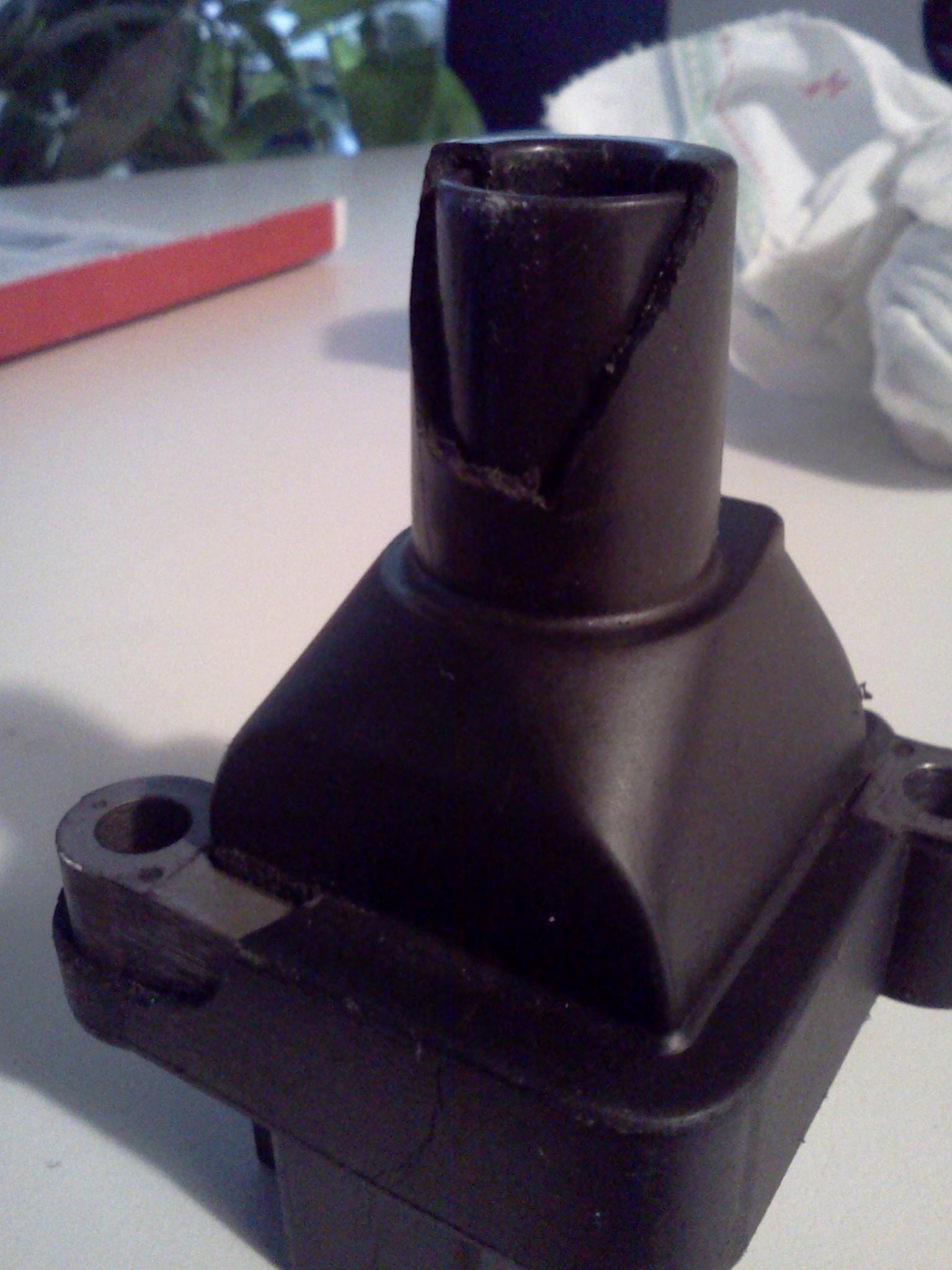

John99Boxster 11-16-2011 11:22 AM
Got the coil pack.....replaced the old one in cyl. 4. Drove it "Like the Doctor Ordered" and no misfire!!
Feels good to accomplish little things!!!:dance:
Picture of old coil...missing 3 pcs./cracked:
http://986forum.com/forums/attachment.php?attachmentid=15656&stc=1&d=13214713 26
