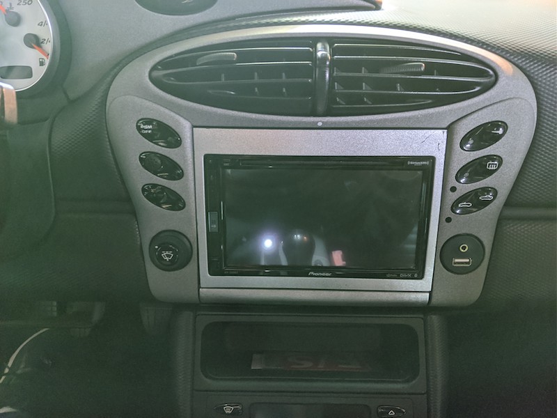

My Pioneer AVH-2550 NEX is installed. I am spoiled now having Android Auto / Carplay in my 2019 Pilot, and knew it was one of those "can't live without" type things for me. While I was in there I decided to fix the foam flying out the vents problem as well. I followed the "cut from the front" approach first proposed by 78F350.
Here are some shots of how that came out:
http://986forum.com/forums/uploads02...1577488043.jpg
http://986forum.com/forums/uploads02...1577488061.jpg
http://986forum.com/forums/uploads02...1577488078.jpg
I found the 3M tape that was discussed that should handle up to 300 degrees. It seemed to work really well. If it has any longevity issues I will update here.
http://986forum.com/forums/uploads02...1577488150.jpg
Here is the headunit in the kit send by crutchfield, I sprayed it with Testors 1830MT Diamond Gloss to try to match my sport design trim. It is close, the amount of metallic "speckle" is spot on, the color is a bit more sliver then my more gray trim.
http://986forum.com/forums/uploads02...1577487975.jpg
I also installed a USB / AUX jack in place of the lighter, and am really pleased with how this came out. Here is a thread that shows more detail on installing that piece.
http://986forum.com/forums/uploads02...1577488325.jpg
I ended up having the shave the retaining nut quite a bit to get the horseshoe back in the dash.
http://986forum.com/forums/uploads02...1577488455.jpg
bg305 12-27-2019 03:20 PM
Continued...
I don't like talking on the phone in the car and would have ditched the pioneers mic completely, but it was used for the voice control with Android Auto, which I use all the time. I hated the idea of mounting the mic anywhere visible though. After staring at the dash for a bit trying to find locations for it and envision how the wire would have to be run, it occurred to me that it might be able to "poke out" through one of the blank switches in the horse shoe. I figured worse case I just need to find another blank if I mess up and went to work. I am really happy with the way it came out. I have not made it permanent yet, as I want to see if there are any usability issues with it picking up my voice all the way recessed like it is. It is winter here in NY and I am not planning on driving it until march or so. Once I get a chance to see how it works I will glue up the small gaps.
http://986forum.com/forums/uploads02...1577488507.jpg
http://986forum.com/forums/uploads02...1577488523.jpg
http://986forum.com/forums/uploads02...1577488540.jpg
I also managed to scuff up my paint a bit :( on the top right corner of the plastic kit surrounding the radio, I tried hitting it with a bit of touch up, but it is pretty visible. A lot of my "Sport Design" interior pieces are scratched a bit, And I want to take them all out and sand / respray anyway, but this will be another project. I tried spraying the radio bezel kit with it other then my added smudge spray at the end, I think it looks pretty good.
http://986forum.com/forums/uploads02...1577488580.jpg
http://986forum.com/forums/uploads02...1577488612.jpg
http://986forum.com/forums/uploads02...1577488632.jpg
http://986forum.com/forums/uploads02...1577488647.jpg
So... many boxes checked on my winter boxster todo list! yay!

Wild_willig 03-02-2020 05:35 AM
What wiring harness should I use for a new headunit?
bg305 03-02-2020 07:55 PM
Crutchfeild provided mine.
You just tell them the car making model and they know what head unit you're buying and they suggest it.
Can't recommend them enough had a great experience purchasing from them. They have a number you can call to talk to someone to make sure you get everything correct.
