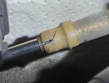

clickman 07-08-2025 09:06 AM
Yes, those cheap plastic wipers on the sheaths...
Here's how I found one of mine during the last maintenance day. I wrapped it tightly in vinyl electrical tape. Let's see how long that lasts.

bcrdukes 07-08-2025 09:39 AM
Thanks for sharing!
By chance, are your cables original?
clickman 07-09-2025 06:28 AM
Yes they are
