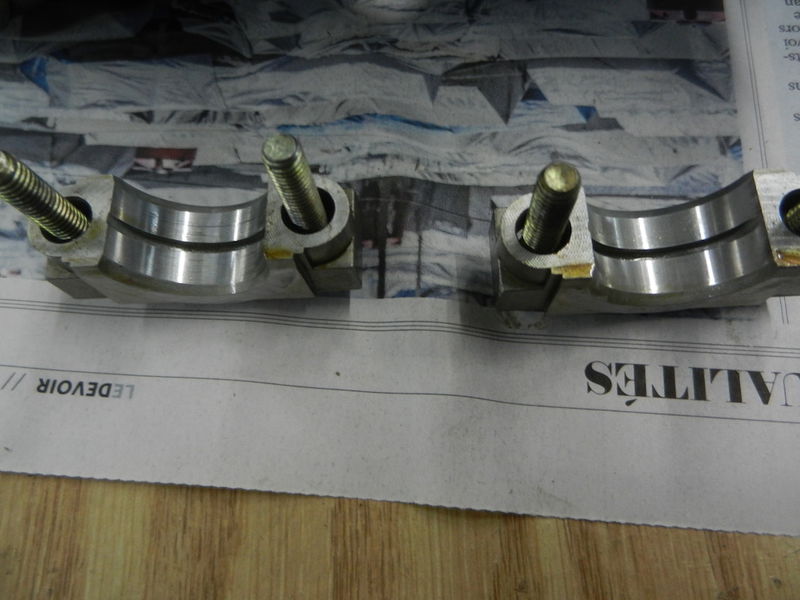

elgyqc 05-17-2024 06:55 AM
What worries me is the bearing surface in the head, the last photo in the initial post. The other surfaces are smother and shinier.
These are the bearing caps (that are the top half of the bearing that I worry about... they look good.
http://986forum.com/forums/uploads02...1715957627.jpg
and these surfaces at the other end of the camshaft are smooth and shiny.
http://986forum.com/forums/uploads02...1715957492.jpg
Maybe I am panicking for nothing, but it is the first time I have noticed this on the four engines I have disassembled to this point.
Homeoboxter 05-17-2024 09:21 PM
That's not an issue. And you can't fix it anyways, unless you replace the head.
elgyqc 05-21-2024 04:04 PM
Thanks Homeoboxter, your opinion carries a certain weight with me. So you figure I should just reassemble it and not worry. I realise that the alternative is to replace the head which I evidently really do not want to do.
Homeoboxter 05-23-2024 09:54 AM
I've seen worse, this is not an issue IMHO. There's a lot more to worry about in this engine :)
