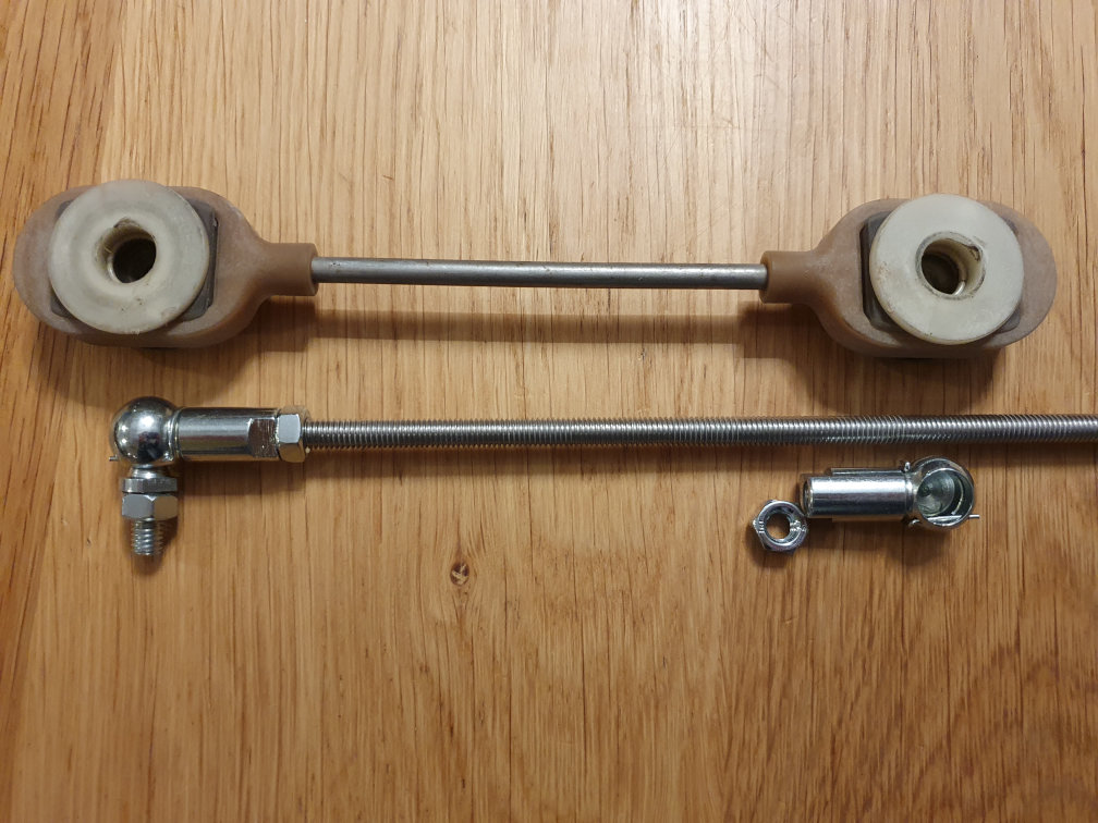

What did catch my eye though is that they have made part of the linkage similar to what I intend to do:
Attachment 23608
So replacing the rubbery stock part which does allow a lot of movement side to side with a solid part. Easy to make and try, and easy to swap back to stock if it does turn out to be too spartan. Seeing their part being so equal actually makes me confident of this improvement.
