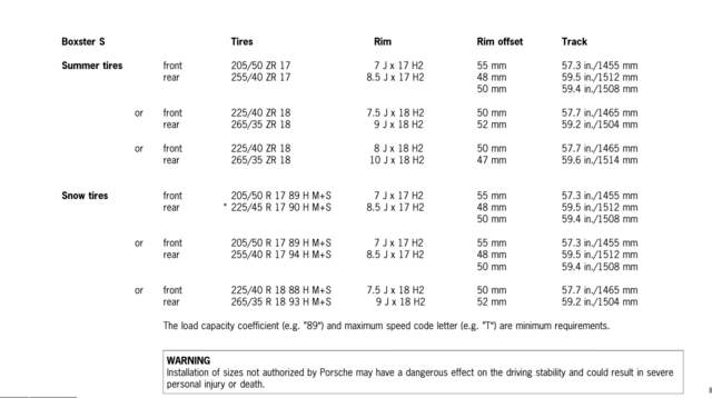

PaulE 08-23-2021 12:13 PM
This table from the Boxster Owner's Manual (not sure what year) may help in picking a spacer size. Since 10 inch rears for a Boxster have a 47mm offset and your 997 rear wheels have a 58mm offset, a 10 or 11mm spacer may work on the rear. And on the front, the 8 inch Boxster wheel has a 50mm offset and the 997 wheels have a 57mm offset, so maybe a 7mm spacer. You will also need to change your lug bolts to longer ones to account for the spacers. They might also fit without spacers, but you would have to mount tires and check clearances. The handbrake cables may also need to be ziptied away from the tires.
