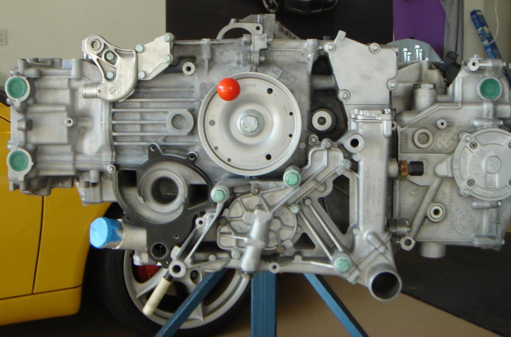

I have a 2001 Boxster S+ engine for sale in the classified thread.
Attachment 22868
