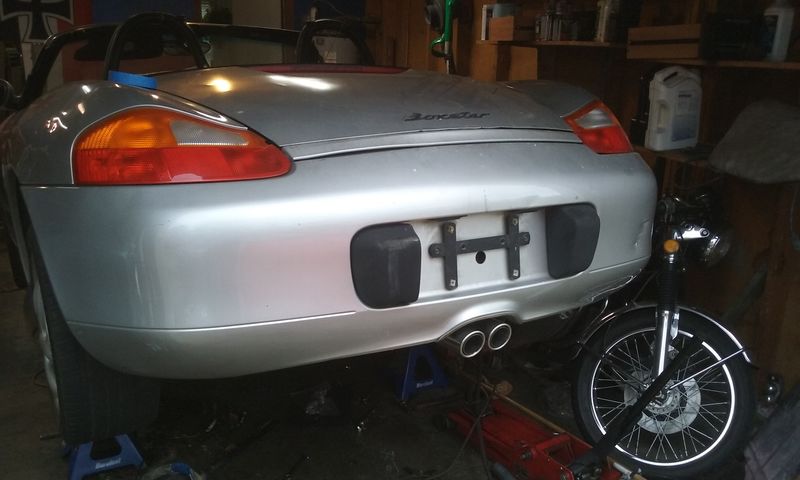

Got my cheapo ebay muffler, but I'm not running a stock engine. So I hope it doesn't drone. :D
http://986forum.com/forums/uploads02...1584405132.jpg
