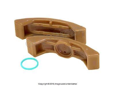

Are you talking about chain guides? [img]
http://986forum.com/forums/uploads02...1532217613.jpg

chain guides, for cams
Lew,
yes, I want to change these out. Any new design, material that has been updated since 2000? I want the newest material for it.
