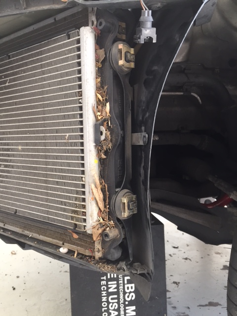

So I've been working on the accusump install and I'm waiting for hose and fittings to complete the job. While I was waiting, I decided to pull the bumper and clean the rads. They weren't terribly dirty, but I noticed that the condensers have about 25% of the fins flattened out by what seems to be road debris... but the A/C still works well.
Since I had the bumper out, I decided to fab some grills to cover the air intakes so that it would prevent large debris from entering the ducting. I also pulled the plastic inserts (left and right) and painted the visible trim black. I then purchased some roof gutter mesh grill and fabbed, painted silver and then secured the pieces behind the insert grill pieces. This is what it looks like. I think it looks pretty good and should do the job. My other concern was not to impede the air flow, but I think the mesh is large enough that it should not reduce cooling capacity.
