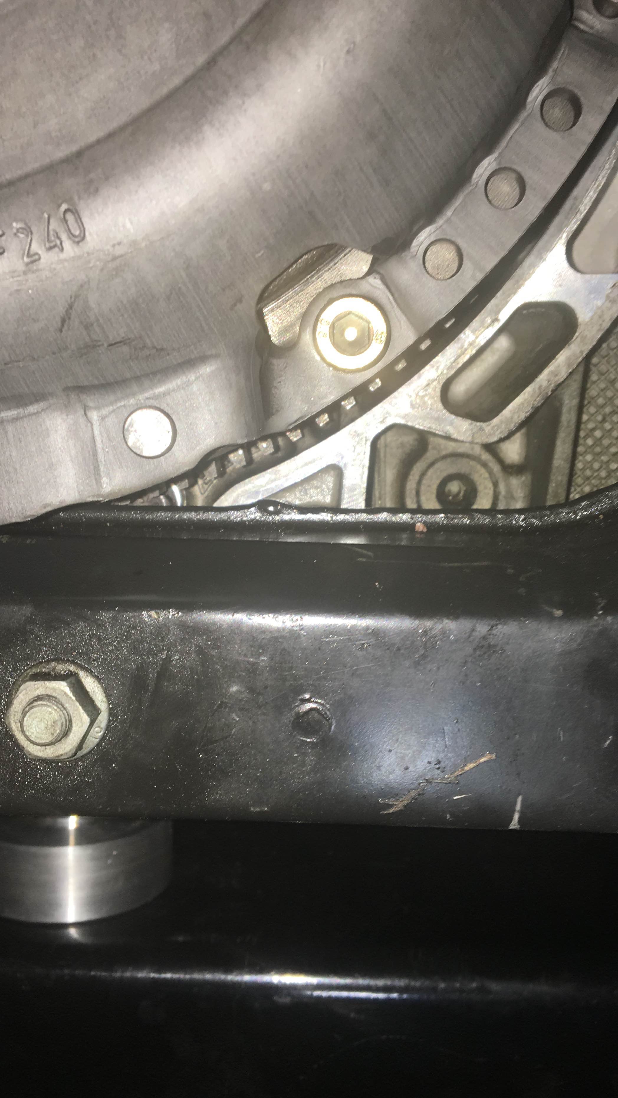

Attachment 20480
Fluid pooling in the bell housing

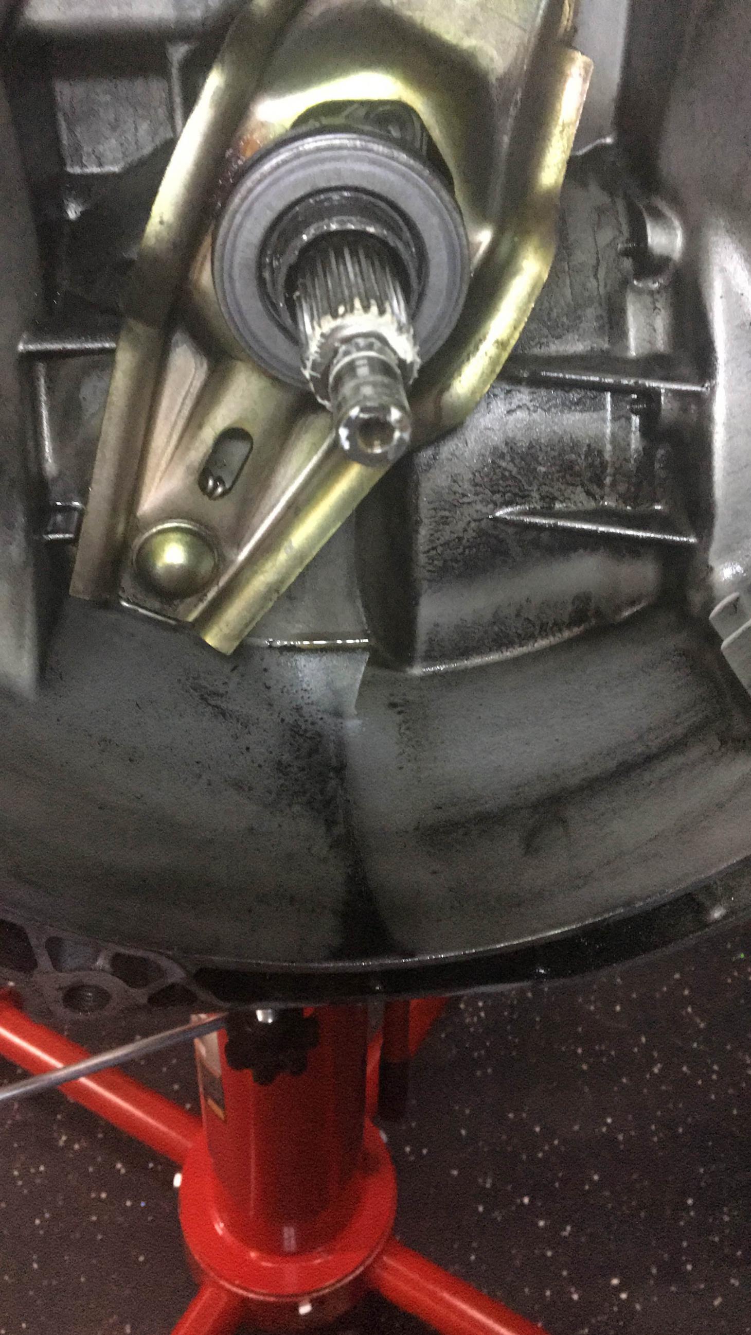

Attachment 20481
Behind the flywheel appears to be dry.
Is there an obvious diagnosis or should I proceed to pulling the clutch and the flywheel? What say you experts who are smarter than I? Thanks for the help!
hoyabob2003 09-07-2016 07:30 PM
...and on further inspection, the inside of the bell housing is coated with an oily substance....if that helps. Thanks!
