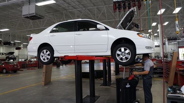

A lot of this is all semantics. All shops worth their salt use pressure filling systems, either bulk or batch, to fill transmissions. This could be something as simple as a hand pumped tank (batch) or pull down over head lines (bulk) commonly seen at larger facilities:
https://c1552172.ssl.cf0.rackcdn.com/354341_x800.jpg http://pictures.dealer.com/t/toyotao...d99aa5a55b.jpg
Both deliver the fluids under slight pressure, but just enough to get it into the transmissions. They are not flushing systems, but delivery systems. A pressure flushing system attaches to the external fluid lines on cars equipped with such lines, and push clean fluid through the transmission, pushing out the old fluid:
http://g02.a.alicdn.com/kf/HTB1DK6xI...pg_640x640.jpg https://w220.ee/images/thumb/2/20/72...on_Diagram.JPG https://i.ytimg.com/vi/8QcpnVOvQqA/maxresdefault.jpg
Pressure flushing systems operate at much higher pressure than the filling systems, but lower than the actual line pressures developed inside the trans when the car is running.
