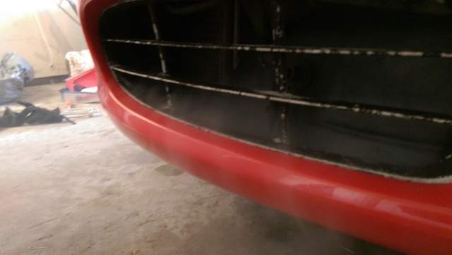

I bought a AC recharge kit, followed the directions but instead of fixing my AC I think it blew out my radiator. As I'm charging the AC I start hearing a hissing then smoke starts coming from the passenger side radiator and there's a puddle of coolant underneath it. I immediately shut the car off. It hissed away for another 10 minutes or so.
I have no idea what I did or what my next steps are. Can someone please help me out because right now I feel like an idiot. :(

Well for starters the air conditioning condensers are in front of the radiators. So what you see is most likely refrigerant blowing out of a hole in your condenser. Was your a/c blowing cold air at all before you tried to recharge it?

There is a leak in the condenser. It may have been a small leak before if your a/c was kinda working before. It is a big leak now for sure.

It was not blowing cold at all. The pressure gauge read 0 when I started. I periodically checked the vents and I did have cold air blowing shortly before I saw the smoke.
I took a video of the puddle, it seems like green coolant.
https://youtu.be/jStatofU9BQ

Hit something hard recently in passenger front? (i.e parking curb, steep driveway, etc.)
If so, could have taken out both condenser and rad :eek:
Before tossing any more $ at this w/o knowing issues I'd pull the bumper skin ASAP and inspect. Let us know what you find and we can assist from there.

Yes I agree that is coolant. If your a/c system was flat it could be a large leak. It seems possible that when you charged the a/c if the leak was on the side of the condenser, it could have frozen and cracked the plastic side of the radiator. But hitting or scraping the front seems more likely. Has your a/c worked recently? What ever the cause you will definitely need to remove the bumper cover to see what is wrong.

It looks like you barfed up an AC condenser. Could be a rock strike or just old age. Pull the bumper cover for a peek. If you had "0" system pressure to start with, there was already a good size leak present.
As for your oily substance, there is oil in with the refrigerant charge to lubricate the compressor. Betcha that's what you're seeing there.

+1 My bet is you need a new condenser, pull it apart and check. If you have the correct coolant it is pink not green. If it is the condenser you have not screwed up, your AC is just shot. Pull it apart and post pictures, we'll help you through it. No big.

I want to thank all of you who talked me off of the ledge! A number of you nailed the issue - My AC condenser is shot so when I was recharging freon leaked out all over the ground and radiator. The radiator was hot hence all the smoke. I was a bit intimidated but thanks to a great YouTube video taking the bumper off was straight forward. The AC recharge kit included a UV additive and light so it was pretty easy to spot the point of failure. Looks like I'm staying AC-less for now and I'm OK with that.
On a related note, good god there was a TON of crap stuck in there. I expected some debris but this was far beyond what I expected.
