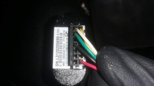

One of my P-cars has this doodad mounted under the dash, to the left of the steering wheel in no particular mounted fashion other that being wired in. Any ideas? I looked up #'s and searched -- so far, nada. :(
'99 Boxster
Please see pic -- barcode lists SN:L3120205699 / IMEI:358696046774918
http://986forum.com/forums/uploads01...1440006704.jpg
Deserion 08-19-2015 10:13 AM
This is what the IMEI number pulls back to:
https://www.u-blox.com/en/product/leon-g1
My guess from the product info is that it's a tracker, possibly installed if the car was previously on a buy-here-pay-here lot or with a bad credit lender.
drew44 08-19-2015 10:13 AM
name that part
Google:
xpyleong100
Looks like some kind of aftermarket tracking device.
One post I found talked about an aftermarket keyless remote starter.
Good luck!
JeremyConnors 08-19-2015 10:21 AM
Thanks guys, excellent leads! Think I thought I saw something about a remote someplace when switching number around. And the dealer was mighty sketchy come to think of it, so maybe she was under surveillance! I'll keep digging to decide whether it's gotta go or not.

JayG 08-19-2015 02:23 PM
some of those things connect to the ignition and if disconnected the car will not start
others are like Lojack and can get you a discount on insurance
Meir 08-20-2015 04:06 PM
this is a GPS tracking device.
usually installed by the "by here pay here" dealers.
that specific device is made by Enfora, and sold by many GPS companies.
here is just few of them:
