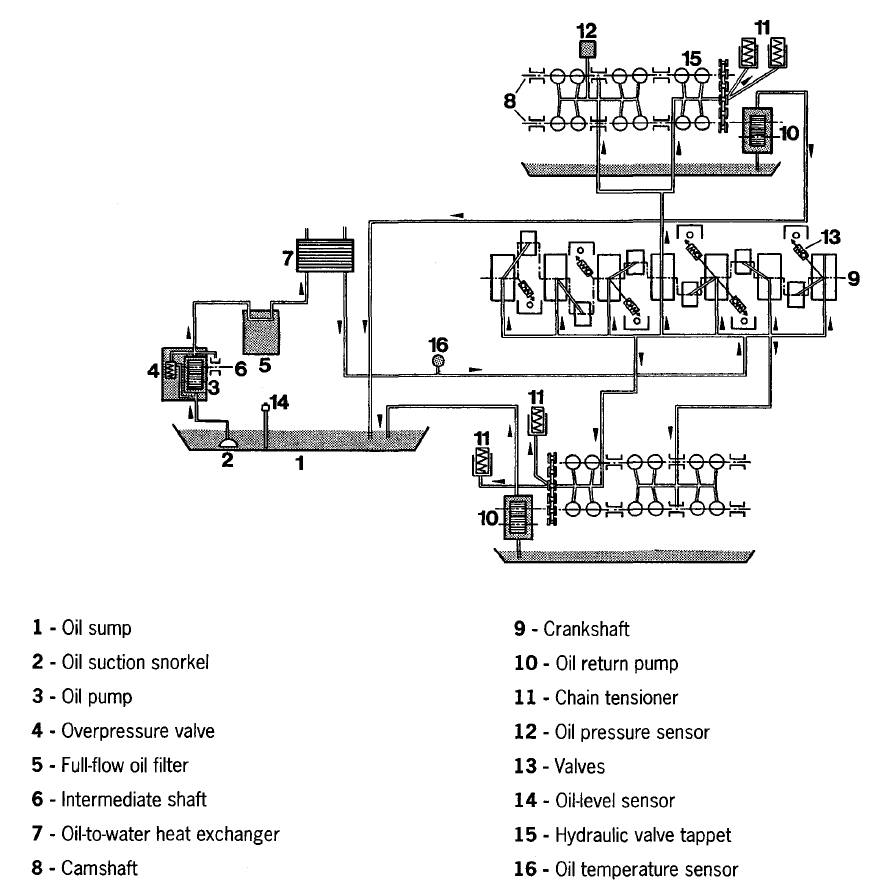

The reason the oil is routed to the oil filter is that it goes from there through relatively large oil passages to feed the rotating assembly, which balls up quickly at high revs and without oil. Feeding oil back into the heads requires the oil to go though small passages backwards before it sees the rotating assembly, which simply could take too long.
http://www.renntech.org/forums/uploa...1319393736.png
